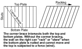

I am a homeowner doing a minor remodel of my new 60's single-story rambler. I drew and submitted plans to the city, and they reviewed and approved the plans.
One of the changes is a new window towards the corner of the house in a bedroom. It is a tall but narrow window (30x72), with the first king stud located 2' 6" from the corner of the house.
I am doing demo, and have run into a series of diagonal blocks running from the ceiling to the floor in this corner in the way of the new window opening. I am familiar with let-in bracing for shear strength, but this seems different as it is not "let-in" to the studs, rather mitered pieces of 2x4 nailed between each stud. I always thought the strength of diagonal bracing like this came more from it being continuous, and am curious how much this blocking is actually doing.
I can find an engineer to consult if needed, but wanted to see what people here thought of how effective of a roll this is playing as it stands and perhaps how advisable or not it would be to remove. It seems what is there already wouldn't meet prescriptive code for a shear wall.

Unless you are in a seismic zone propose continuous wood sheathing on the inside and put extension jambs on the window trim
Assuming that the plans were approved without mention of the blocking or a need for a shear wall it should be okay. It is worth pointing out that just adding wall bracing accomplishes little unless the braced wall segment is restrained top and bottom.....to a degree that keeps it in place during an event.
Let in bracing can actually reduce the lateral strength of a wall.
What is shown is typical of much older construction.
The diagonal bracing shown is actually not very effective. It is not clear how one would calculate any strength it would provide in compression and would not be effective in tension.
The straight sheathing shown has minimal capacity. Older is not always better.
With the addition of the new windows I would look very carefully whether some additional lateral strength needs to be provided.
Since you are planning an addition I would talk to an engineer now in case it would be beneficial to do something now that would benefit the future work.

Diagonal bracing assist in Plumbing and Aligning walls during framing
Diagonal bracing assist in preventing racking
Diagonal bracing assist with tension and compression of walls in a wind or seismic event.
One way to keep the frame aligned, is to plywood the wall, inside or Outside.

Follow up: I am reading about braced wall panels in the IRC, and it looks like according to R602.10.2.2, a braced wall panel must begin within 10 feet of a braced wall line. Though I'm still learning the terminology, I believe the previously pictured corner of the house would be the start of the braced wall line. The rightmost edge of the right window gives me *just* enough room to fit in a braced wall panel.
It also appears that the Simpson WBC bracing, installed in an 'X' would be acceptable here as it is allowable in-lieu of let-in bracing. This would by far be the easiest for me to install and would not conflict with the window position.
