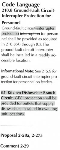

Update: 2018
A dishwasher now requires GFCI. That changes things up as far as readily accessible is concerned. I have also been told that since the receptacles under a sink for the dishwasher and disposal is less that 6' away from a sink, the disposal will be on a GFCI receptacle as well.
All of this is common knowledge but I noticed a guest looking at this thread so I figured I should correct it some.
ICE, I believe the 2017 NEC, (2018IRC) has increased the DW plug-in cord to 78-inches to make it easier to get to that receptacle!
I don’t know but I’ve been told that a gfci under a sink is not readily accessible. I don’t agree with that. The premise that under a sink is “within six feet” is also a stretch.
Affirmative according to the definition and 2014 Analysis of Change (below). And then to add the 2017
Accessible, Readily (Readily Accessible). Capable of being reached quickly for operation, renewal, or inspections without requiring those to whom ready access is requisite to actions such as to use tools, to climb over or remove obstacles, or to resort to portable ladders, and so forth.
