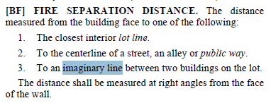

I'm trying to figure out distance between the primary dwelling and an accessory dwelling on a single residential lot. I'm assuming one would just use the FSD of IRC302. If there is 10 feet between the house and detached ADU there would be no required fire rating or opening limitations. If they were 8 feet apart would you use the imaginary lot line? For example the lot line could be 5 feet from the existing house and 3 from the ADU. Therefore only the ADU wall would need a rating. Thoughts?
Imaginary? Correct me if I'm mistaken, but there either is or isn't a lot line, right? What's the imaginary line for?
THE IBC uses the concept of an "imaginary lot line" when discussing the fire-resistance rating of exterior walls of two (or more) buildings on the same lot (parcel). Unfortunately, the exact term "imaginary lot line" seems to occur only in the Commentary:
However, the definitions include the term "imaginary line" under the definition of Fire Separation Distance. In my corner of the world, we generally refer to the "imaginary lot line" as the "fire separation line."
Back to the original poster’s question, the imaginary line is for the purposes of treating each dwelling independently for purposes of allowable area calcs. Washington building code allows you the option of treating them as one building:

Otherwise, just follow Residential code R302.1(1) or (2) as anpplicable, and don’t worry about imaginary property lines.
If an ADU is an "accessory structure" (as seems only reasonable) then I take R302.1 Exception 2 to mean that you don't have to consider the distance between the structures in determining the fire separation distance for exterior walls of either structure. You just consider each structure separately with respect to the lot lines and street centerlines (per the definition of Fire Separation Distance above).
Whereas if you have a residential lot with two main dwelling units on it, no ADUs, then the "imaginary line" portion of the Fire Separation Distance definition comes into play. I infer you can put the imaginary line where you want so that both main dwelling units comply with R302.1.
See 705.3
Cheers, Wayne
I haven't had to deal with ADUs yet, but based on R302.1 Exception #2, that's the way I understand it. An ADU is an accessory structure to a single-family dwelling, so Exception #2 says we don't have to be concerned with the fire separation and the imaginary lot line.
