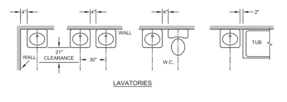

Hello All,
I could have sworn there was a portion of the code that mandated a wall-hung sink must be 4" from edge of sink to edge of adjacent wall. I checked ADA, ANSI 117.1, IPC, IRC, and IBC (2018 and 2021 versions). Does anyone else remember this?

Thank you, everyone. Yes, I am familiar with the various rules regarding centerlines of sinks/lavatories to walls. But I thought there was some code somewhere that had an additional rule which mandated 4" minimum of clearance between the edge of a wall hung sink to the adjacent wall. The thought being that if you had a 32" wide wall hung sink for example you not only have to ensure the centerline requirements are met but also have to ensure it wasn't directly abutting the wall (but rather held off 4"). Anyone?
Maybe I found it? 2006 IRC R307.1 requires the 4" number in the location referenced above. The reason is so you can reach around it to clean the sides. I could have sworn this was in a more recent code, though.
I'm not aware of the 4-inch distance requirement, I think the distance is coming from a wheelchair forward approach and the wall hung sink being centered.
4-inches along a wall for protruding objects might be where that's coming from, but that's a guess.
This appears to be from the days when the 15" distance to CL only applied to WCs and urinals. The 2006 IPC has the 15" distance for lavatories. It looks like the 4" edge distance disappeared in the 2009 IRC, but the 15" distance to CL for lavatories first appeared in section 2705.1 of the 2009 IRC.
This is part of Figure 7.3.2 Minimum Fixture Clearances (for other than accessible applications) from the 2018 and 2021 National Standard Plumbing Code.
