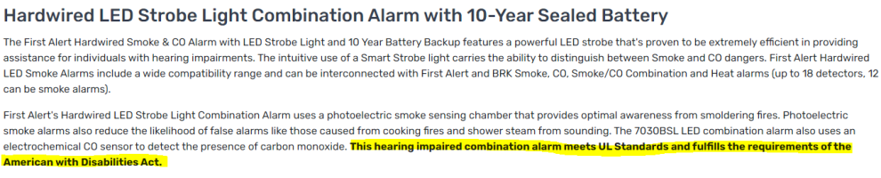

I say "yes", and it won't be the first time that a manufacturer has (IMO erroneously) claimed ADA compliance.
Example:
First Alert Hardwired Smoke and CO Alarm with LED Strobe Light and 10-Year Sealed Battery - 7030BSL (1038870)
But wait - - open the Owner's manual, and it says the strobe won't operate during power failure:
ADA 809.5.2.1 requires visible alarms in communication units. During a power outage the audio alarm will operate but the visible strobe won't. And a power outage is when residents are more likely to use candles or other open flames in their units.
So, under ADA 233.3.5, how is this an equivalent facilitation for persons with hearing impairments?
BTW, I'm not picking on First Alert. Kidde and other manufacturers have the same issues.
At the moment, I'm not sure I can have an ADA compliant communications unit using all-in-one combo units without also adding an external battery backup + inverter.

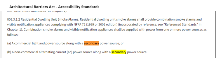

Mark, are you saying that because ABA 809.3.1.2 refers back to NFPA 72, and because (per mtlogcabin in post #8) NFPA 72 29.6.5 does not require the strobe to be on battery backup, then 809.3.1.2 does not require battery backup for the strobe?
Also, can you provide a link to the ABA? I notice that 809.3.1.2 is not the same ref. numbering system as the 2010 ADAS.
ADAS has similar language. For example, see 2010 ADAS 809.5.2 and 702.1 that reference NFPA 72. However, I don't see those ABA exceptions in ADAS.
I'm pretty sure the ABA wouldn't be applicable here unless the project has federal funds and/or falls under the jurisdiction of HUD, GSA, DOD, or USPS.

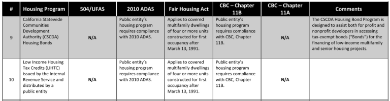

I do a lot of tax credit projects. The California DSA has determined that 2010 ADAS applies.
https://www.dgs.ca.gov/-/media/Divi...access/ch_11B/DSA_Public_Housing_Guidance.pdf
No mention of 504/UFAS in line 10, but I think the "N/A" really means I need to achieve 504 compliance via the Deeming Notice (with its exceptions) and the 2010 ADAS.

OK, so here's what I've found. When projects have federal funding to comply with UFAS, then ABA 809.3.1.2 applies - - but the ABA website says HUD did not adopt ABA.
