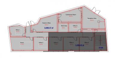

We have a client who is interested in exploring the possibility of adding a mezzanine or second floor level above an existing area in a large multi-story assembly building. The area we would be working on is 3,088 square feet. While there are existing elevators in the building, they wouldn't be able to service this new space. The current space, which is a rarely-used open reception room, is set to be repurposed into offices. To meet the required number of offices, we must consider vertical expansion. However, given both a mezzanine or intermediate floor scenario, would ADA requirements necessitate the construction of a new elevator? We are in Florida.
For reference, below is a rough sketch of a single idea. The darker gray represents a mezzanine.
It is our professional opinion that vertical accessibility should always be provided. At the same time, it is our responsibility to present the owner with various options and potential exceptions, should they exist. I also plan to seek advice from our local building official for their input.

In the IBC, the 3000sf requirement pertains to aggregate area of all spaces not on the level of accessible access. Meaning you would need to calculate the total area of both this area and any other basement or upper story or mezzanine.
How is it in any way a mezzanine? What exiting space would this proposed "mezzanine" be in? Is it between the floor and the ceiling of an existing space?
Can you post a cross-section showing how it might qualify as a mezzanine?

OP did not limit it to being a mezzanine and has not likely seen the other threads where you have discussed the topic of what constitutes a mezzanine.
An accessible route is not required to stories, mezzanines and occupied roofs that have an aggregate area of not more than 3,000 square feet (278.7 m2) and are located above and below accessible levels.
Why doesn't the proposed 1030 SF 2nd floor addition not fit in this?

We have not been given approval to proceed with any drawing development. We were asked to produce an abbreviated feasibility assessment concerning the potential addition of a mezzanine or intermediate second floor level. There is roughly 25 feet between the floor and underside of structure above in this particular area.

Yes, the offices are intended for employees.
The OP wrote that this is a large, multi-story assembly facility. He didn't say how many stories or what the floor area of the other stories is, and that could make a difference. He also wrote that there are elevators -- but the plan doesn't show any elevators. That suggests that we are not seeing a complete floor plan.
The new floor level that we are creating in this space is unique and does not align with any other floors in the building, served by the existing elevators.
