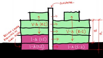

We are constructing an R-2 condominium building, and trying to determine if the elevators need smoke curtains.
Here's the situation:
  • The elevator connects ( 1 garage level + 3 stories of R-2 + 1 level of rooftop access )
  • 4 stories of Type V-A construction and R-2 occupancy (condominiums)
  • 1 level of Type I-A concrete podium
  • NFPA 13 sprinkler system
  • Code based on IBC 2015
What section(s) of the code dictate smoke curtains for elevators?
Your expertise and guidance would be greatly appreciated.

Hi Ron,
The levels served by the elevator are 1 + 4. Please excuse my crude sketch, which I believe answers your other questions:

Your building does not appear to meet any of the five conditions listed in IBC Section 3006.2; however, Section 3006.2.1 requires hoistway protection where corridors are required to be rated per IBC Section 1020.2. IBC Section 3006.3 provides several options for compliance:
  1. Provide an enclosed elevator lobby with fire partitions.
  2. Provide an enclosed elevator lobby with smoke partitions if sprinklered per NFPA 13 or 13R.
  3. Provide additional doors at each hoistway door opening.
  4. Pressurize the hoistway.
The curtain is not required if you use options 1, 2, or 4.
