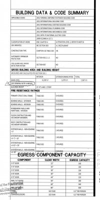

Hello, I really need your help as I’m having a hard time understanding the sprinkler requirements for construction type '5B'. This is about 7000 sq ft, and the previous use was A2, with no changes in the use group.
The building is not equipped with sprinklers, and the exterior wall is a 1-hour rated wall. I received a comment asking me to 'show how the fire sprinklers are not required per VCC (Virginia Construction Code) 2018, section 903.2.' I would really appreciate it if an expert could explain to me how to respond to this comment
I’ve attached screenshots of the building information. For your reference, we are not changing in use group and no change with the structure or exterior

Is this an existing building? If so, why are you asking about section 903.2? If it were new construction and Use Group A-2, then sprinklers would be required. Type of construction doesn't matter, but one of the triggering conditions in section 903.2.1.2 is a fire area greater than 5,000 square feet. But if it's an existing building with no change of occupancy, you should be starting in the Virginia-amended IEBC (2021).
Section 306.1.2 of the IEBC sends you to section 907 of the IBC portion of the VCC. where the building is not protected throughout by an automatic sprinkler system in accordance with Section 903.3.1.1 of the VCC. And section 907 just requires a fire alarm system, not s sprinkler system.

I really appreciate your assistance in clarifying my comment. Originally, the building was designed for a restaurant, and while I'm uncertain of its construction date, the previous tenant adhered to the 2012 VCC, Level 2 renovation standards without encountering any issues regarding sprinkler requirements.
Presently, I am undertaking a "New Tenant Fit Out" with Level 2 alterations, following the 2018 VCC code. My comment requests clarification on how the fire sprinklers may not be required per VCC (Virginia Construction Code) 2018, section 903.2.
I deeply value your expertise and would greatly appreciate a thorough understanding of this matter. It is essential for us to avoid unnecessary sprinkler installations due to budget constraints, especially since we are only conducting a "New Tenant Fit Out with Level 2 Alterations" without changing the designated use group.

To provide further context, yes, this is an existing building where we're undertaking a "New Tenant Fit Out" with Level 2 alterations. My inquiry regarding section 903.2 was misguided, as it pertains to new construction rather than our situation of retrofitting within an existing structure. I am confused because the previous tenant followed to the 2012 VCC, Level 2 renovation standards without encountering any issues regarding sprinkler requirements.
