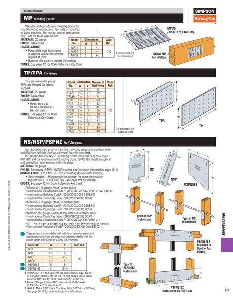

Do they make large nail plates?
Does the IRC plumbing code require that the protection of the pipe extend 1.5" past each side of the pipe?

mtlogcabin,
We called them FHA nail plates. Provides more protection than the normal 1.5 width protector to prevent a nail from passing above the sole plate like when your nailing a 3" or 5" base board. The name FHA may come from an FHA loan inspection requirement I suspect?
PF950s18 5"x18" is one size but I believe they make a smaller one on the length.
pc1
I am under the UPC which only requires protection within 1 inch of the exposed framing member similar to what Ice posted. So technically this is not a violation
My concern is the cabinet installers use some pretty long screws when fastening the cabinets to the wall
Thanks to all for the info on the larger plates. I will tell them to protect the pipe
