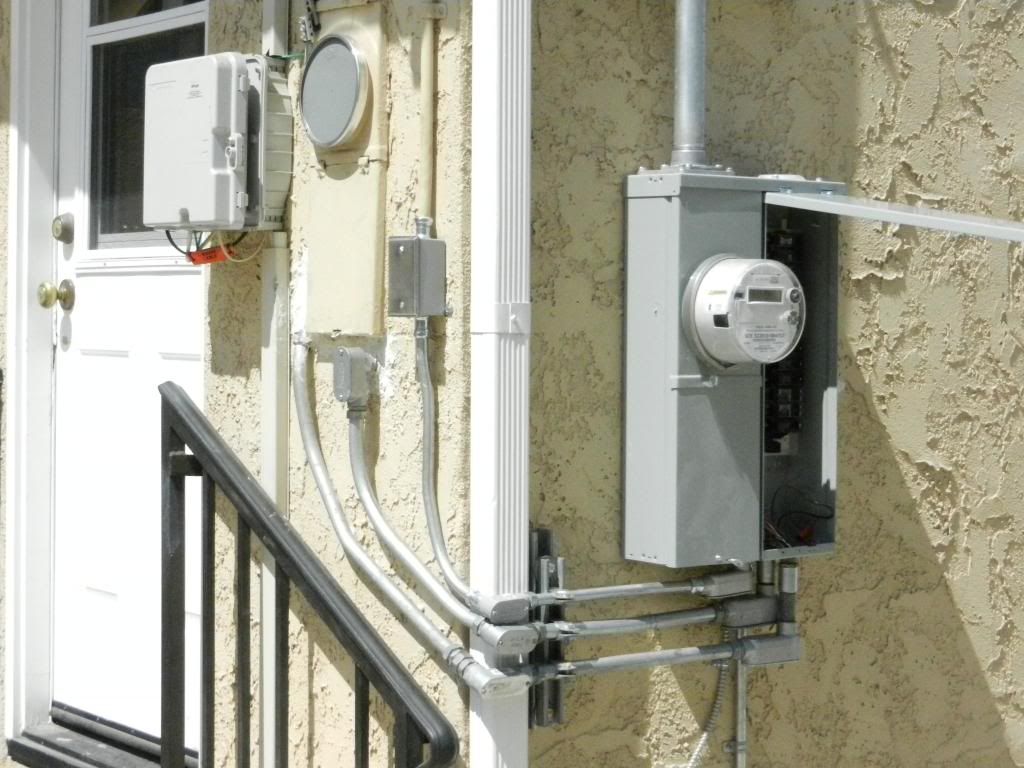

I'm pretty sure that the customer didn't envision this when she hired the contractor.

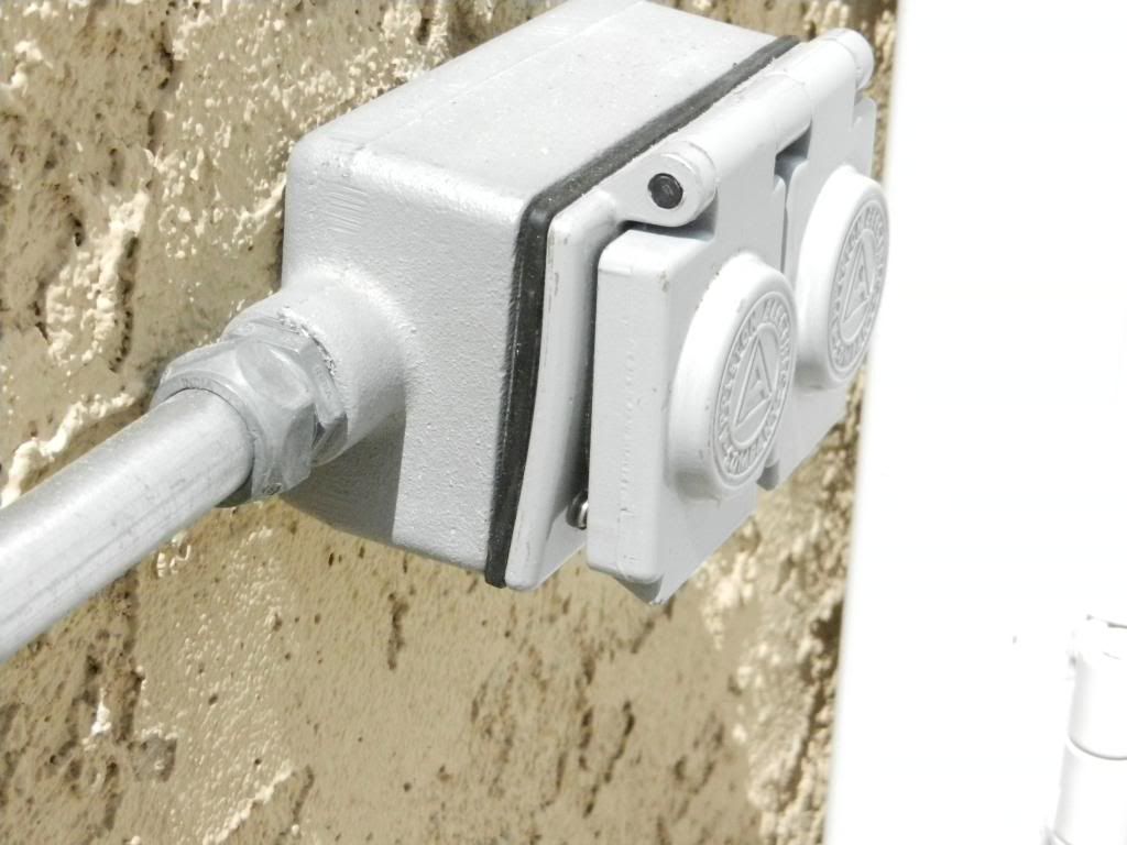

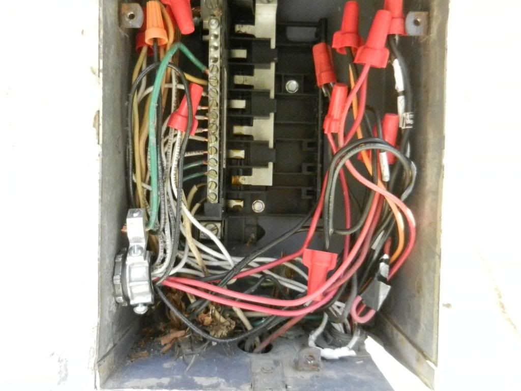

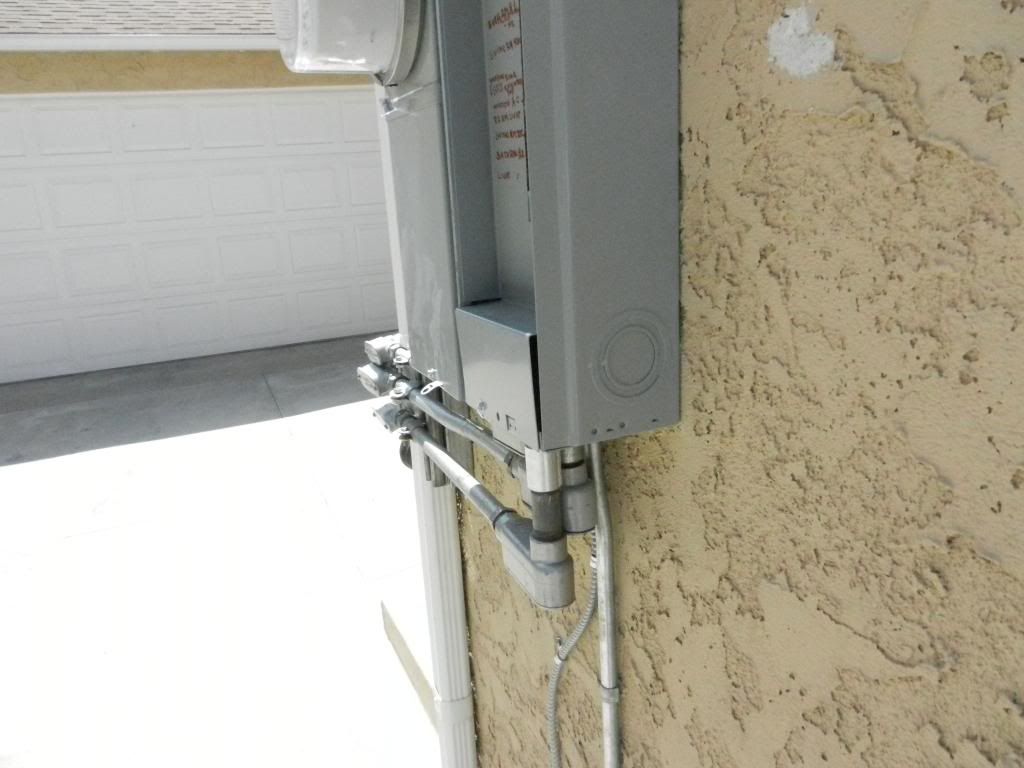

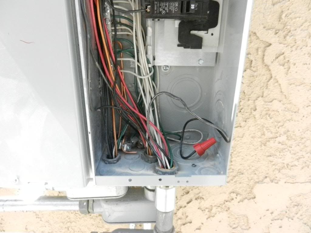

This is the old can that's now a J-box. This job got a lot of corrections. Some that I hardy ever write; like all of the LBs with no gasket. And check it out, some of the LBs can't be accessed unless conduit is removed.
They must think that I don't care.
So back to the question. Do you require a reduction in ampacity for heat and more than three current carrying conductors in a conduit?
The practical number is 9 conductors with "small" THHN (using the 90c column and 240.4(D)) but it is clear that this installation has moved into the 45-50% category.
You certainly have other issues there.
Here is how it works. If you have more than 3 current carrying conductor's then you must derate however when using 90° C wire you can use #12 at 30 amps. As stated above, even with 9 current carrying conductor's the factor is 70% . 30 amps * 70% = 21 amps. Same is true with 14 gauge used at 25 amps. So unless there are 10 current carrying conductor's then it is not an issue unless ambient temps come into play.
Are those emt connectors wp. Compression fittings are not wp. The wp have gaskets inside.
You guys are soooo picky...I mean...this has been in a building for like 20 yrs and it hasn't burned down YET! That pesky code is just too dang strict!
The cover doesn't fit tight. The door latch was removed...probably to make room for a conduit entry.
