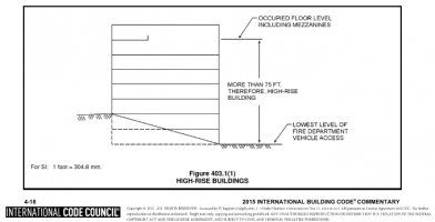

Attached is the illustration from the 2015 IBC commentary, which shows the measurement to the mezzanine.
I believe the use of "floor" instead of "story" when determining a high-rise building was intentional. An occupied roof is also a floor; thus, such a situation could create a high-rise building without adding any actual height to the building.
A mezzanine is a floor, thus its elevation would be considered when determining if a building is a high-rise or not.
