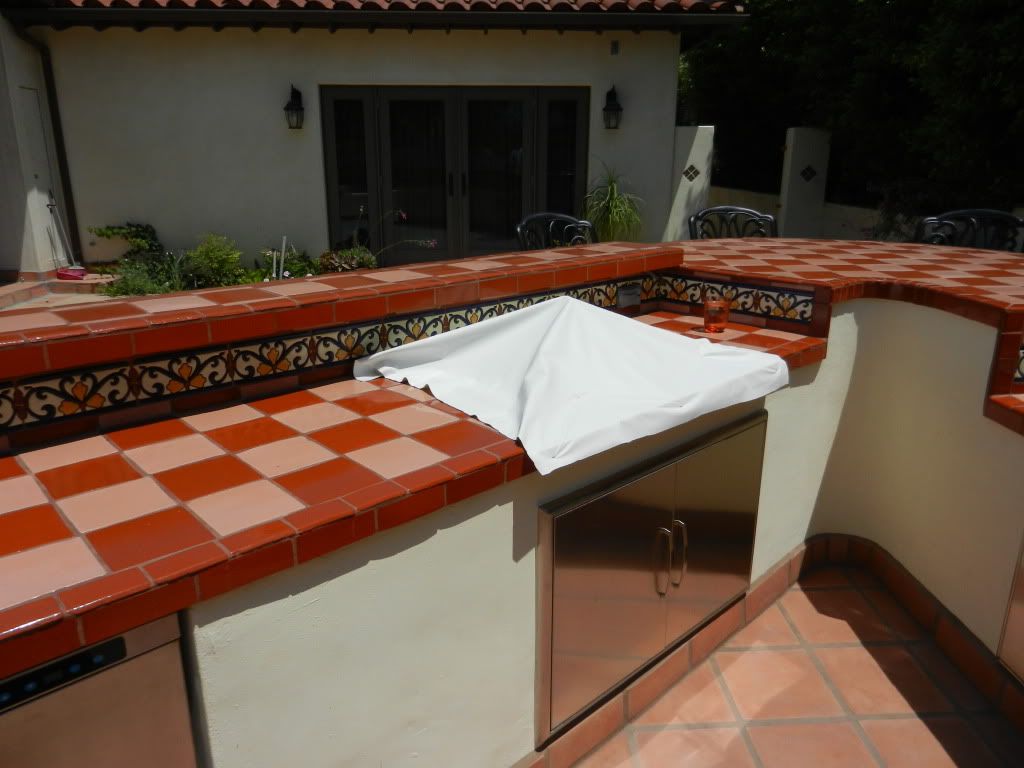

H/O permit for a BBQ island. H/O is a structural engineer. I told him that he would have to cover the sink. This is what he did. He even provided a glass of water so that I could test it.
I have a question: Why would he have to cover the sink?
That is a new one and if it is required I just might have to start enforcing it.

Just in case it rains. We don't want rain water getting into the sanitary sewer system where it will be treated.

So the scope of the problem would be a 6"/24 hour 100 year rainfall event in a hole max say 6.5 square feet that produces
less than a 30 gal trash can full of water. I can see where that would tax the system.
curious would the average annual rainfall even exceed 100 gal

A conservative guess on the number of these in our jurisdiction would be 5000. The gallons that they capture can't be close to 100 each, probably closer to 25. That comes out to 125,000 gallons. In a wet year that could double. I could be way off. A drop in the sewer treatment bucket.
Separation of sewer and storm discharge meets the federal NPDES (National Pollution Discharge Elimination System) and Storm water managementplan, best practices
You have stuck it to the H/O by making him go through the drill but I will suggest that short of outlawing exterior sinks that it will have little effect. How many people will consistently install the cover when they are done, especially if the BBQ gets rained out? How will you enforce continued compliance?

The amount of water that a sink like that will introduce to a sewer, as pointed out, is negligible. Outside floor drains encompassing hundreds or thousands of square feet are a valid concern but to be putting the screws to somebody because a a counter with a sink will get some rainwater in it seems to be pushing it.

Leaky and broken public and private sewer lines are by far the greatest contributor to introducing stormwater into the sanitary sewer in our jurisdiction. I think it is the same in most others.
