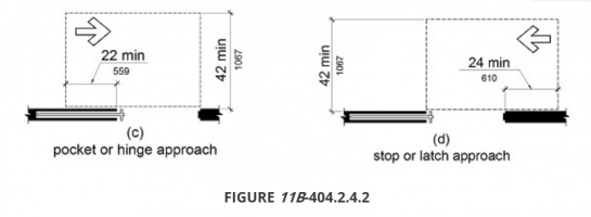

    I'm looking for door approach clearances for pocket doors, or any doors, can't find it in the IBC.

    Look at ANSI A117.1 and/or the 2010 ADA Standards. The IBC references the ANSI standard.

    Table 404.2.3.3 maneuvering at sliding and folding doors...

    David
    I noticed you are in CA
    If the project is in CA, it is under the CBC not the IBC
    FIGURE 11B-404.2.4.2
    MANEUVERING CLEARANCES AT DOORWAYS WITHOUT DOORS, SLIDING DOORS, GATES, AND FOLDING DOORS
