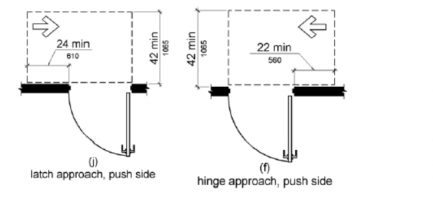

DoorClearance.jpg Okay, 0” allowed by ANSI A117.1
My drawing shows the direction of travel with two (2) arrows indicating a latch side approach.
The doorway could be approached from the hinge side but it is highly unlikely.
According to 2010 ADA figure 404.2.4.1(j) for a door with a LATCH, there should be a maneuvering clearance of 24” parallel to the doorway and measured from the LATCH side.
According to 2010 ADA figure 404.2.4.2(b) for an opening without a door, this maneuvering clearance is zero.
According to 2010 ADA figure 404.2.4.3(c) for a recessed door (because the 8-1/2” brick element is greater than 8”), this maneuvering clearance is 12” measured from the LATCH and push side of the door. This third illustration makes reference to the LATCH side as well as a forward approach.
I have neither a latch nor a forward approach.
My objective is to determine the appropriate landing and clearance for the area highlighted in yellow. For a door without a latch.

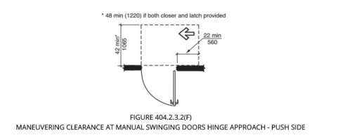

Thank you for the graphic, explains a lot better. Ditto MH!
As shown the wheeler is approaching the hinge side of the door.
Also consider an assist device if this is an existing condition.

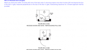

The door is code compliant if the door approach is from the hinge side; However the " recess " makes it non-complaint because the door does not provide adequate floor clearance for forward approach- 52 Inches required. (46" is provided. Notice closure and latch are not mentioned. - No Asterisk).
IMHO even an ADA Door operator doe snot alleviate the requirement for a forward approach as the code requires - I am not sure what what version of ICC ANSI you are using as this is the 2017 ed. that has been adopted by state law where I am at.
It is non-compliant - 1.) either the door has to not be on the accessible route with signage directing people to the nearest accessible entrance , 2.) The door has to be relocated, or 3.) an alternate means to operate the door has to be provided. Those are the only code compliant options.
