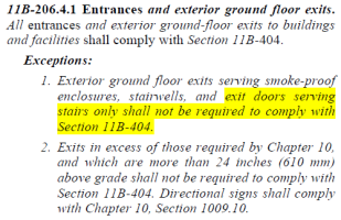

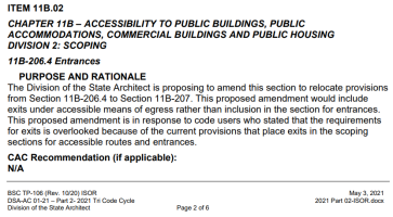

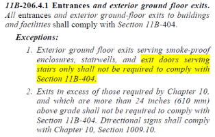

That Exception was not _added_ in the 2022 CBC. It has always been there, but few noticed it because it was under Section 11B-206.4.1 on "Entrances and exterior ground floor exits." For example, here is a screenshot from the original 2019 CBC:
When the DSA proposed relocating the Exception to Section 11B-207, they stated in their Initial Statement of Reasons (ISOR) that they were merely moving the provisions, not changing their meaning or intent:1733187989929.png
Despite whiny blowback from a particularly overzealous but grievously mistaken CASP (whom my firm had the misfortune of working with on a UC project), the DSA stuck to its guns and the provision was adopted. So if you have any public accommodation project under a code earlier than the 2022 CBC, the Exception would still apply to exit only stair doors.
