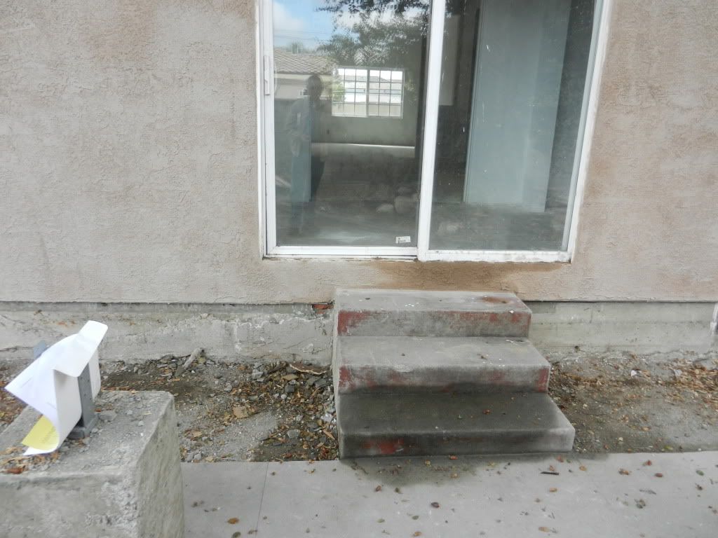

fatboy said:
So you would approve a door swinging over a single rise? Sorry, I'l call it all day, every day. Take it to the BOA, I think we all know the intent here. I know you like to take the devils advocate peach..........
Here you go fatboy. The Devil will let you say no to this one.
