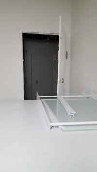

    3BEA8E15-549F-4170-A63A-26773C5DFDDC.jpeg So is the door allowed?
    Does provide required access?

    Is that a shelf in front of the door?

    I do not know.
    It was a picture from someone
    I take it you can open the white door fully,
    And there is three feet of clearance in front of it.

    Is the door opening at least 30 inches wide and 6½ ft. AFF?

    Section 240-24(d) (NEC), “Overcurrent devices shall not be located in the vicinity of easily ignitable material, such as in clothes closets.
    So if it is left alone, it maybe fine, no shelves.... It probable should labeled, if commercial. this maybe residential.

    Panel flush with wall, no violation. Recessed, 110.26 violation.

    110.26 (A)1...the wall is in the working clearance, it starts from the face of the enclosure.....

    (1) Depth of Working Space. The depth of the working space in the direction of live parts shall not be less than that specified in table 110.26(A)(1) unless the requirements of 110.26(A)(1)(a), (A)(1)(b), or (A)(1)(c) are met. Distances shall be measured from the live parts or from the enclosure or opening if the live parts are enclosed."
    3' from the front of the enclosure needs to be clear.....Flush, good, recessed, bad...

    The exception is only good for less height......you still can’t place a panel like the drawing you provided.
