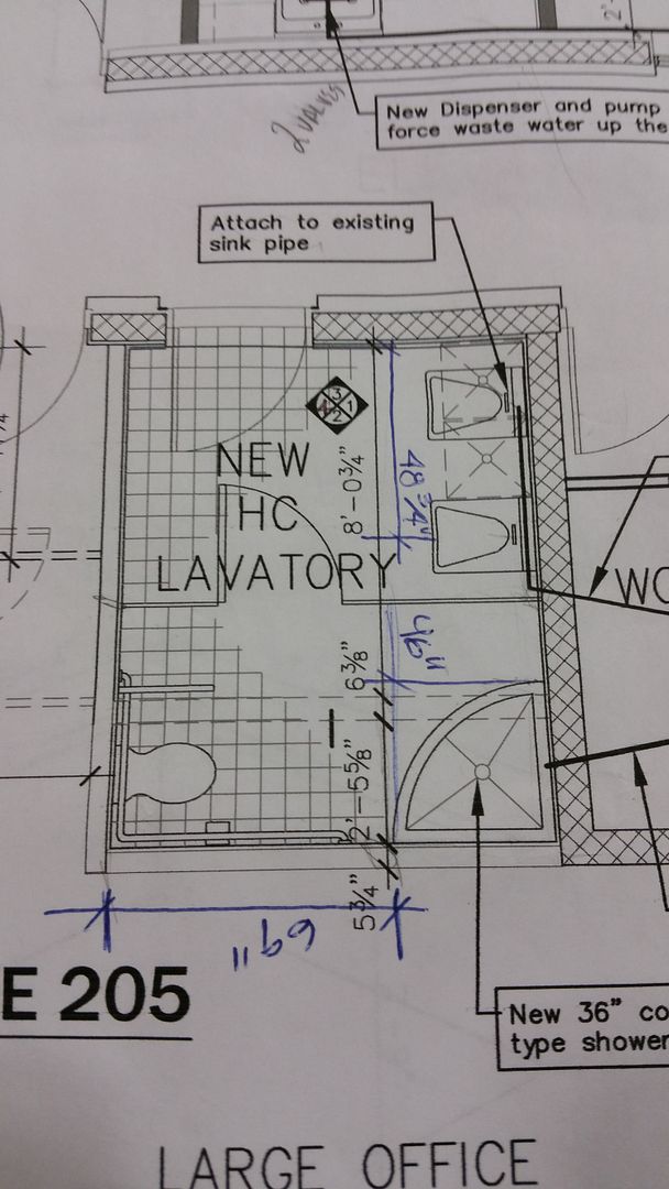

The doors in the plan Steveray posted would be considered inseries unless there is a turnaround space outside the door swings.
The plan Yikes posted meets the IBC, as long as the bathroom and adjoining room doors swing 180 degrees. The required corridor width is 36", IBC 1005.7.1 says "Doors, when fully opened, shall not reduce the required width by more than 7 inches (178 mm). Doors in any position shall not reduce the required width by more than one-half." This requires a 4'-6" wide corridor when a 36" door swings into it. The minimum to get a 2" frame + 34" door + 18" maneuvering space is also 4'-6".

Make it a single user Restroom. A case could be made that the user must close the exterior door before opening the interior door. Both could have closers.
Thanks Mark, they came in with this revised plan on Thursday at about 4 for a Friday morning inspection and said "we added a shower"...and I told them it needed to be accessible. It is an office building. I can't get the cocktail napkins to go through the scanner to post a residential plan... :)

It is accessed by the common corridor...Not sure how the use would be limited. Open to whoever is in the building IMO. 1109.2(?) gives you the partial gimme for "private" bathrooms, but mentions nothing of showers.
