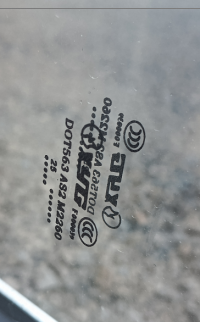

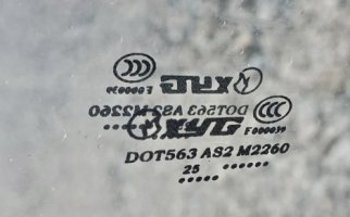

DOT "safety" glass - warning
Inspector Gadget
Mar 5, 2020
1,337
New Brunswick
Our office has seen a rather alarming influx of people using DOT-rated safety glass in such things as residential guards on decks. Below is an image found in the exit door of a Part 3 building under construction. In all cases, the installer/distributor has stated "you're the first one to complain about such things," which might be smoke in the colon ....
BUT it's worth raising for discussion.
I also, earlier this year, had an issue with a glass-filled residential door from (IIRC) Belgium that had Euro markings. In that case, the manufacturer was able to state that the glass also met ANSI Z97.
EDIT: Part 3 reference is 3.3.1.19(7) which refers to 9.6.1.4

The tests for DOT glass and ANSI Z97.1 glass are *entirely* different.
DOT glass is tested with a small object dropped from a large height; ANSI Z97 glass is a large object dropped from a small height. Totally different tests.
And I'm not going to put my career at risk by approving something that may not, in fact, be suitable for the job.

Yeah, I know (well, assumed) they were different. And like I said, I wouldn't approve it either. But I'm willing to bet that it can pass the tests it's suppose to test to because a car is subject to a lot of stress (and the glass, assuming it's windshield glass serves a structural component in vehicles too). They just need to show me that it can, otherwise they're going to have to replace it.
