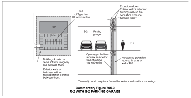

Irrelevant. That's not discussing an opening through a fire wall, it's discussing exterior walls of two separate buildings. That's addressing a very specific situation where an S-2 parking garage building is erected immediately abutting an R-2 building. That's not an opening through a fire wall. What that exception is doing is providing that the burden of protecting the opening(s) is to be entirely on the S-2 building, without requiring opening protectives for the R-2 building.
Commentary:
Exception 2 takes into account a practical design
issue.
The great majority of multifamily projects are being
built with parking garages beside apartment buildings.
Access from the parking garage into the apartment
unit’s floor is provided at each garage floor onto the
apartment’s floor for convenience as well as for safety
for the apartment dwellers. Many designs have one or
more of the exterior walls of the parking garage and
the apartment building at a 0-foot fire separation distance.
The requirements within Table 705.8 would prohibit
any openings in these exterior walls between the
parking garage and the apartment building. Based on
the protection afforded by the sprinkler system in the
R-2 use and the inherent fire safety of the parking
garage, this exception would allow these openings.
See Commentary Figure 705.3 for an illustration of this
condition.

The IBC Commentary is clear that only one fire door is required. I didn't reproduce the illustration that accompanies 705.3. Here it is:
BUT ... this is a specific condition, applicable only to a parking garage abutting an R-2. And the exception is talking about two buildings with a zero fire separation distance. For an interior fire wall with no fire separation distance as a consideration, I can't see any practical reason for building two walls where only one wall is required.

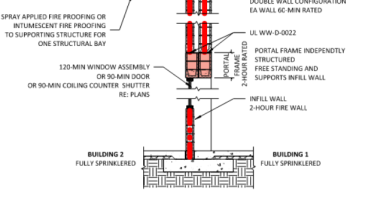

So then we get to the opening question: the designer wants to use the two fire walls, but use a single fire door that is structurally independent from both walls. That would (in theory) allow the opening protective to remain if the building on either side collapses. But if the door ratings in the IBC opening protective table call for 1-hour in what is supposed to be a 2-hour fire wall, based on the expectation that it's actually going to be TWO 1-hour doors, then a single 1-hour door in what is supposed to be a 2-hour fire separation isn't enough. It should be a 90-minuted door, at least.
But I don't see anything in the IBC or in NFPA 221 that seems to allow this so-called "portal."

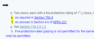

And don't forget the footnotes:
Clear that each wall is required to be rated 1-hr to replace a single wall. Not clear that each wall gets it's own opening. They clearly use a column heading of "Each wall of the double wall assembly" over the required rating for the double walls. They do not include that above the column for the fire door rating. Seems like that would have been included.
I can't reconcile the reduction from a 1 1/2 rating to a 1-hr rating if it is a single opening as a portal. I also see some viability to a portal if it can be designed to remain in place...with a 1 1/2-hr door.

The proposed independent "portal" with a single door is an interesting concept, but I don't see how it can be detailed to work, and I also don't see anything in the code that allows it.
the independent portal is fairly easy to accomplish on the ground level. If the building / fire wall is multiple stories I am not sure how that could be accomplished.
It is on the first floor on a 2-story. I spoke with ICC technical staff and he agreed the code table does intend that each wall have an opening protective, but that it isn't crystal clear. Likely not anticipated, because NFPA prohibits it. As far a portal frame, it may comply with the intent of structural independence if that can be verified, but I would want this through an AMMR, with a 90-min opening min.
It took awhile but here are the details. Still have questions about the openings but they are proposing a 90-min door in the portal frame at least. They have requested an alternate from the CBO for the portal frame concept and the single openings. The plan is to create a double masonry fire wall, and at each opening create a structurally independent portal. Essentially create a single fire wall within the double fire wall for the opening, with a 90-min opening protective. Actually using U904 so each wall is 3 hour.
Now, check out the fire window detail...each has a 1-hr window.
This structure is cut into 3 buildings by these fire walls. The fire walls are swiss-cheezed with openings (they have not provided the opening width calculations but looks to exceed 25%).
