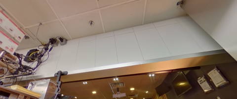

at my current job, we do commercial work in restaurants. We've had a discussion at my office concerning the requirements of draft curtains. I was told that they are only required in NYC. This is usually behind the front counter and are used to mount the menuboard on. Sometimes in a remodel of the store we have to modify this. In NYC we have to make sure it matches the existing construction which in NYC is usually onw or 2 layers of gyp board. We had a discussion about if this is required only in NYC to have a fire rated draft curtain system. Also a lot of times there are sprinklers directly behind the soffit. Some people refer to this as a deluge system. Isn't there two things going on here? A deluge system is different from a draft curtain?
A deluge system is an automatic sprinkler system in which when activated ALL the heads go off simultaneously. In a standard NFPA 13 system, each head is activated separately by a fuse located in that head. What you are describing does not sound like a deluge system -- unless NYC uses non-industry-standard terminology.
Yes this issue comes up in NYC. Our client which is typically a McDonald's restaurant usually calls it a draft curtain. My understanding of a draft curtain is that it keeps smoke from traveling throughout the space when there is a fire, which is a different issue than what the the sprinklers are for, if I'm understanding it correctly. They usually have sprinklers directly behind the draft curtain / Menuboard soffit. When we modify the area behind the counter we usually say to match existing construction as far as the soffit goes. Usually we make it one or two layers of gyp board going all the way to the deck. A lot of the times we dont know what the existing construction is.
I was under the impression this was a draft curtain used to keep smoke from spreading throughout the restaurant. There are usually sprinklers right behind it, spaced 4'-0" apart. There is some cooking equipment in the kitchen, but these are usually fire rated in NYC

Is a deluge system typically a fully sprinklered space? You wouldn't have just some sprinklers around the menuboard soffit as in my photo. that would not be a deluge system?
Not necessarily. We see deluge systems a lot in Canada to create a water curtain for stages. The rest of the building might be sprinklered, it might not.
The selection of sprinkler system is based on both the code requirements and NFPA 13 requirements.
You will typically only see deluge systems in buildings that have a crazy high hazard of fire or where the risk of damage to fire spread is high, but damage from water would be negligible. It is relatively rare to see full deluge systems and when you do the water demand and pressure requirements get crazy very fast. Sprinkler systems are rarely designed so that all heads can operate at once, with deluge being one of the exceptions.
A water curtain is not a deluge system.
I agree, but will point out that deluge systems as used for proscenium open protection (stage and auditorium) are very frequently referred to as water curtains, however incorrectly. But people refer to "sprinklers" as "heads" and I know from code committee and hearings the correct term is "sprinkler".
I "think" water curtains use a different type of sprinkler, one that is fan shaped, and I have mostly seen them on large glass areas in lieu of protected exterior openings and draft stops.
