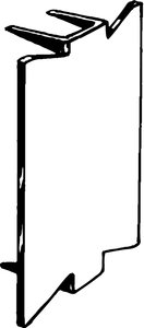

Won't work. If the hole is less than 1¼" from the face of the stud, it needs a nail plate. The title of 300.4(A)(1) is Bored Holes, not Distance from Stud Face to Where the Cable is Placed.

Something like this.
051411628994
Cost = less than a dollar when purchased in volume.
