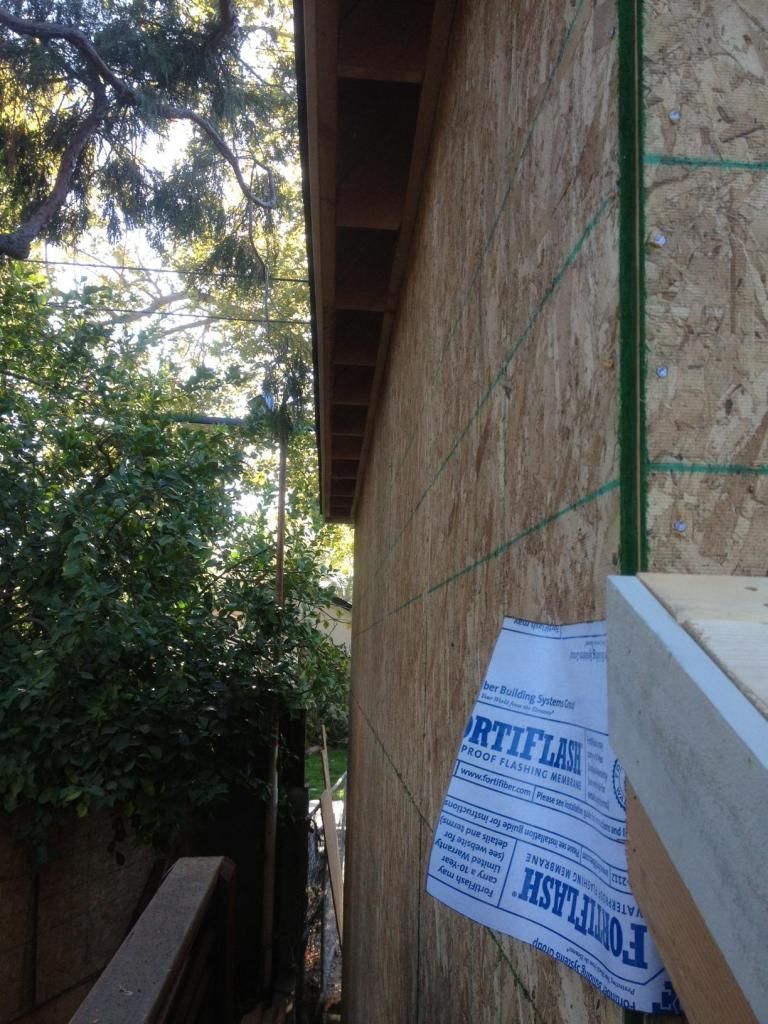

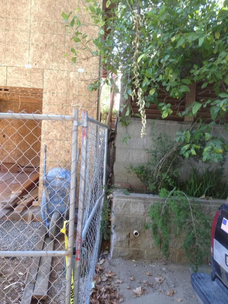

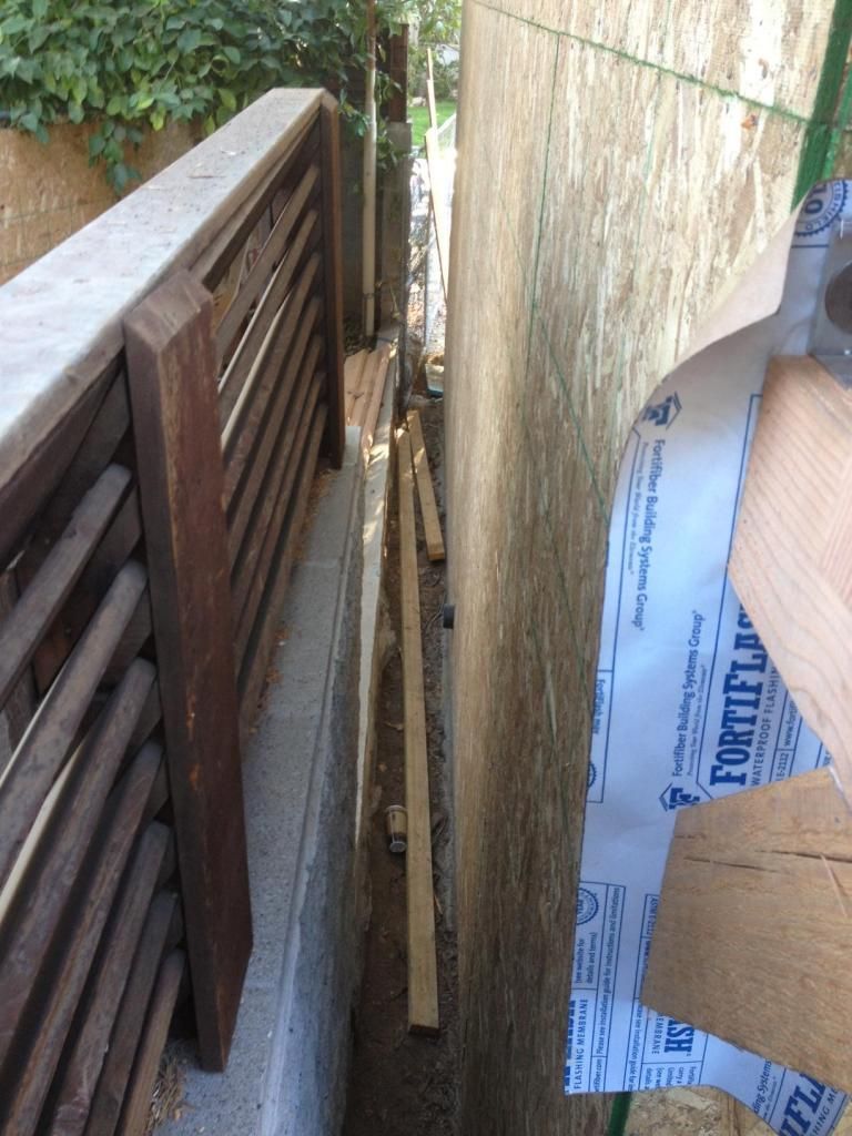

This cottage is one foot from the property line. 7/16 osb and 3 coat stucco. Under eave is getting ext 5/8 drywall.
Does the wall itself need 5/8 ?
Inside will be 5/8 too
Thanks
Brent
The stucco would hold back the fire but the heat would transfer straight through.However, IBC Table 721.1(2) (2012) does list several approved 1-hour fire-resistive plaster assemblies. I wonder if one of these approved assemblies is the same as what was installed?
