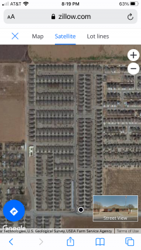

I'm new to the forum, so be easy with me. I have a property owner within my jurisdiction who is planning to put in multiple duplex units and rent them. He would be the sole owner of all the duplexes and the property. Would this type of community be considered solely residential, or would it be considered a commercial project as well due to the sole ownership of the property? I'm just trying to find the appropriate route to take and any help would be appreciated.

From a Building Code, accessibility comes in at 4-or-more connected dwellings.
Zoning looks at dwelling units per lot.
In CA 4 or more units on the same lot is considered commercial. Some interior components of individual units can be treated as residential but the accessibility/structural/fire all treated as "commercial"... To the best of my understanding anyways...

The community is in the unincorporated area of the county and the county has adopted 2015 IFC. The biggest reason for the question is He is trying to play on what he is required, either having to construct a road at County standards vs. build emergency access roads throughout if required.

I've been curious whether more people would weigh in on this. If the community would look anything like the screenshot I've attached, I'd say commercial. It strikes me as apartments arranged in duplex buildings.

I don't know what this has to do with fire codes.
There is nothing in the code that says anything about ownership. Go by what the scope is in the IRC says is a One or Two family dwellings. It's a One or Two family dwelling no matter who owns them or how many they own or how many are on the same property. Don't make something up that is not in the code. You don't know who the owner will be next year and what their intentions are, like if they will be selling some of them.
