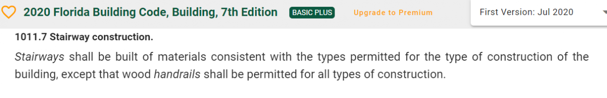

See if the Fl Code has a similar section
2018 IBC
1011.7 Stairway construction.
Stairways shall be built of materials consistent with the types permitted for the type of construction of the building, except that wood handrails shall be permitted for all types of construction.
