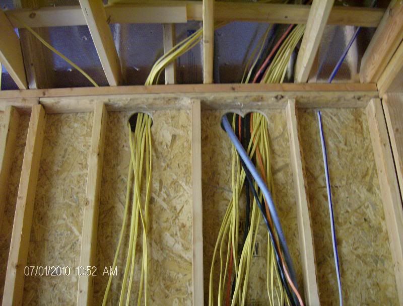

I haven't seen this before. The electrical installers; cut out the exterior osb and ran the cables around the top plate; instead of through the top plate.

interesting.........how do you secure the cables correctly? Wouldn't work here, by the time you get the blocking in there to properly secure the cables, you are taking up insulation space the the IECC requires.
I've seen it two or three times here (two or three different contractors)..... after changing it out the electrical contractors no longer do it this way.
Never seen it done that way, in a fire I would think the soffit will be a straw. A hole counts as a staple right? That's a double hole, get your fire
caulk out!

In addition to the above comments, ...wonder how they are going
to comply with Section R703 - Wall Covering [ i.e. - "exterior walls shall provide
the building with a weather resistant wall envelope." ] ?

In the picture it appears that the cables are going through the top of the panel in and are secured properly..at the box. Usually service panels are located only a couple of feet from the top plate sooooo it is possible that the wires are secured above within 4.5 feet of the panel.

What is the finish on the outside? Looks like the cables could catch a nail in a heartbeat if siding is applied.
With any overhang at all there will not be any siding in that location. Overhangs typically in this area of the country are usually 16" to 24" putting the siding about a foot below the top plate.

One of the allowed uses for draft stopping is insulation. Since this is an exterior wall...insulation will be placed over the hole toprovide draft stopping.
dcspector said:
What about 300.4(A)(1) and 334.30
300.4(A)(1)
(1) Bored Holes. In both exposed and concealed locations, where a cable- or raceway-type wiring method is installed through bored holes in joists, rafters, or wood members, holes shall be bored so that the edge of the hole is not less than 32 mm (1¼ in.) from the nearest edge of the wood member.
I would not consider this application to fit any of the specified locations.

This is above the "weather resistant envelope". As stated above it is typical in this area of the United States to have a 16" to 24" overhang. Thus putting the soffit below the holes in the osb is where the weather resistant envelope is protected by the soffit out to the facia.

From a structural standpoint I think going through the sheathing is better than going through the plates.

You are correct! Insulation will fill the wall area covering the big holes in the OSB, I can go with that. And GH has a good point, I sometimes see the electricians hack out the plates!

Can you please cite a code section where the exterior sheathing is "typically" not
required to be installed up to the top plates, ...in your area or another area of the
country? Simply because it is "typically" performed that way in a certain area,
does not mean it is approved. :D
I can't find where it IS required to be up to the top plate. R703.1 says it has to be "behind the exterior veneer". I realize 703.2 says it has to be applied over studs or sheathing of all exterior walls, but once the soffit overhang is boxed in, is the portion of the wall that extends above the bottom of the soffit considered an exterior wall? If you go to the definition of EXTERIOR WALL, it gives an example of a wall enclosing a mansard roof as being an exterior wall. That means the wall behind the mansard is not considered an exterior wall and I believe the portion of the wall behind the soffit overhang is the same type of example. But I am not the AHJ over it.

If this is inside the thermal envelope I would refer to:
N1102.4.1 Building thermal envelope. The building thermal envelope shall be durably sealed to limit infiltration. The sealing methods between dissimilar materials shall allow for differential expansion and contraction. The following shall be caulked, gasketed, weatherstripped or otherwise sealed with an air barrier material, suitable film or solid material.
Insulation is not an air barrier material.

I don't see how those cables are remotely properly supported OR protected from damage... the sheathing is going to damage itself everytime wind moves the wall.

The framers do go all the way to the top plate. I'm trying to say that where the eave turns out could be part of the envelope...therefore cutting a hole in the osb is not part of the envelope...????????
