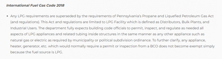

You are wrong. I posted this before. You are wrong. This is directly from the PA L&I UCC Website:
Ok so we need to inspect only appliances' and only tubing when only inside structures, not outside. no other kind of LP piping?
Inside piping/tubing, furnaces, boilers, LPG water heaters, etc. Nothing really different than natural gas. The natural gas meter is outside; the LPG tank is outside. Inspectors were always under the impression that they were not to inspect anything that was even connected to LPG, including the piping and appliances. That was never the case.
This was missed by so many inspectors throughout PA including myself. I recall being taught incorrectly as well and seeing a few muni inspection forms notating propane excluded from inspection. Then it was said so many times in the field the bldrs regurgitated same and took offense to any person who dared to inspect propane. This is real world example of an inaccurate interpretation spreading throughout an entire state.
A small handful of bldrs preferred having the piping and test reviewed and noted.
I learned quickly I’m not fighting the fight I just say amendment changed and forward the text.
