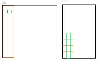

I have an elevator serving 3 mezzanine levels within 1 story/room. By definition, the mezzanine levels are open to the story/room. The elevator hoistway penetrates the mezzanines, and does not abut to other walls/rooms/spaces. You can walk around the 4 sides of the hoistway at ground and mezzanines.
I'm lost in a loop:
712.1.9 Two-story openings, item 3: What is considered "concealed"?
712.1.11 Mezzanine: Vertical openings between a mezzanine complying with Section 505 and the floor below shall be permitted.
713.4 Fire-resistance rating: The number of stories connected by the shaft enclosure shall include any basements but not any mezzanines.
- I had concluded I could apply 712.1.9 if I used a metal screened enclosure so that the opening is not concealed.
- I concluded it becomes concealed if I use gyp walls, which becomes a shaft, which requires a 1-hr rating.
- Is there a case where I can have solid gyp walls, but not the 1-hr rating?
- Does adding glass, open louvers, or metal screen to gyp walls help comply with 712.1.9, which would remove the 1-hr rating requirement?
- Can this be considered an atrium, and would that remove the 1-hr rating requirement?
- Does the fact it is only 1 story/room remove the fire-rated requirements altogether?
