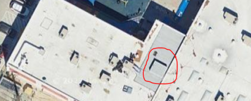

A two story elevator shaft has an overrun roof that protrudes above the roof of the Type II-B building it's in:

I say that 2.7.1.1.1 defines the extent of the fire resistive enclosure: it must separate the space from the remainder of the building. The top of the elevator shaft is not contiguous with the remainder of the building. It has its own roof that is above the roof level of the rest of the building, as seen in the aerial view below. Thus the entire space of the shaft is in compliance with section 2.7.1.1.1 for being separated from the remainder of the building by fire resistive enclosure.

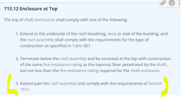

ASME A17.1-2004 2.7.1.1.1 "Spaces containing machines, control equipment, sheaves, and other machinery shall be separated from the remainder of the building by a fire- resistive enclosure conforming to the requirements of the building code"
IBC 3002.1 "Elevator, dumbwaiter and other hoistway enclosures shall be shaft enclosures complying with Sections 712 and 713."
IBC 713.12 "A shaft enclosure that does not extend to the underside of the roof sheathing, deck or slab of the building shall be enclosed at the top with construction of the same fire-resistance rating as the topmost floor penetrated by the shaft, but not less than the fire-resistance rating required for the shaft enclosure."
Your roof would only have to be rated if there is a state or local amendment requiring a fire-rated roof.
