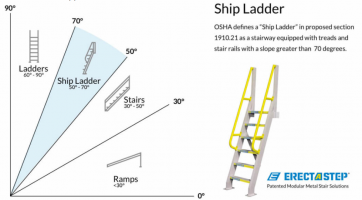

I'd rather use a ships ladder than a regular ladder any day....If you can, and it meets it, that is how I would go...

One of the interesting things for me is that we have specific code for ladders, ships ladders, and alternating tread devices, but apparently no code whatsoever for stairs from an equipment platform. That makes me question if it is intended or not.
And no requirement for any of them to or from an equipment platform.
My opinion is that it is equipment that isn't regulated by building code but OSHA. Much like a construction sites, factories, etc. are OSHA. Some may disagree but the building code doesn't regulate the equipment itself, anymore than the maintenance of the equipment which is generally what the platform is for. If the stairs meet OSHA requirements they should be fine. Or remove and use a ladder to access.
I proceeded without making them comply. Unless I learn definitively and differently that is the way I will approach it from now on.
