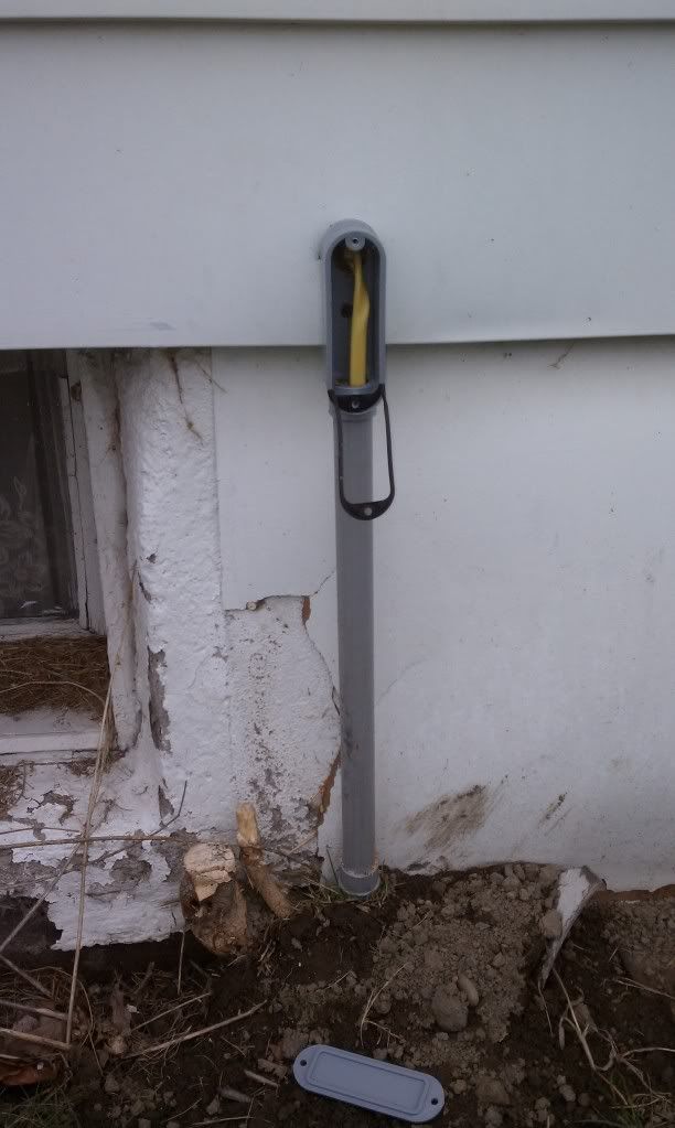

Is there a code section that says you can't run NMC in conduit? I understand possible heat issues, etc. but I can't find a code section....

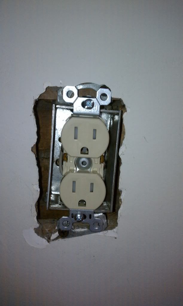

Does the outlet receptacle fiber washers have to be removed between the box and outlet? 250.146 (a)
don't think romex is approved for wet locations,and that fibre washer is just there to hold the screw for packaging. box should be bonded.
You can run NM cable in a raceway, you just can't run NM cable in a raceway that is in a wet location such as outdoors. ;) :)
Check out 300.9 and 334.12(B)(4)

CODE VIOLATION HINT PICTURE 1: What type of conductors and cables can be installed outdoors?
CODE VIOLATION HINT PICTURE 2: Anyone know how to repair drywall?

480sparky,Does the outlet receptacle fiber washers have to be removed between the box and outlet? 250.146 (a)
Beats me.... I can't tell from the photo.
