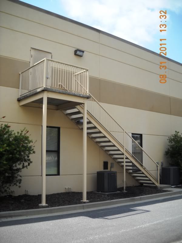

not typically enforced in many jurisdictions, but if you read the definition for exit discharge, it describes a means of egress to a public way. now you have to ask yourself, is a light over the exit door good enough, or do I now need site lighting to the public way too?
It is only required at the landings

Are talking about the requirement for illumination emergency power (1006.3), or required means of egress illumination (1006.1), including the exit discharge (that portion of a means of egress system between the termination of an exit and a public way)? I agree emergency power for illumination may stop at the exterior landing, but as I read it, MOE illumination shall continue to a public right of way.

Exterior Emergency Illumination includes exterior egress components located above the level of exit discharge and landings located at the level of exit discharge. I admit #3 is contrary to #5 in the wording seems to require the entire exit discharge to be provided with emergency illumination

Just to clarify, a MOE shall be illuminated to the public right of way, however, in the event of a power supply failure, only the areas listed in items 1-5, shall be required to be illuminated by emergency power?
The requirement for exit discharge illumination, including emergency lighting, has been in the BOCA building code since at least 1975.
In 1975 it only required emergency lighting of the "exitway discharge" in "department stores of over 5,000 square feet area, places of public assembly, schools, institutional buildings and hotels with sleeping accomodations for more than 25 persons..."

OK - Here we go.
In the review of the codes from 2000 IBC, it appears that the requirements for exterior stairs have remained relatively unchanged. In other words, what you see wrong today, was wrong in 2000.
Installation is allowed by section 2006 IBC Section 1023.6 Exception # 1. (1026.6 Exception 1 in 2009 IBC)
The Main items that appear to be deficient are:
Emergency illumination - 1006.3 (2006 and 2009 IBC)
Handrail Extensions (1012.5 -2006 / 1012.6 - 2009)
Guards - Required where walking surface is more than 30 inches above grade ----- The handrails (34 to 36") and guards (42") are required to be at two different elevations (1013 - 2006 & 2009)
Open Risers - Must be unable to pass a 4 inch sphere (open risers are allowed but the openings exceed the allowable - (1009.3.3 - 2006 ed / 1009.4.5 -2009 ed.)
Weather Protection - Unfortunately, the steps are not sloped and allow accumulation of water (1009.5.2 - 2006 ed. / 1009.6.2 - 2009 ed.)
The landings here are in accordance with the building code - the stairway width is 36" and the landings meet the minimum 44 inches in width.
Kudos to the individual who stopped the tripping hazard on the fourth step from the top - It was a humane rat trap sitting on the step....
Thanks to everybody who participated, I hope to post these types of photos on occasion.
One other possible code section to discuss - IBC 1009.6.3 -2009 ed. Last part of paragraph
There shall be no enclosed usable space under exterior exit stairways unless the space is completely enclosed in 1 hour fire-resistance-rated construction.
The open space under exterior stairways shall not be used for any purpose.
Does the Air Compressor in this photo violate this code section? What is your interpretation of this and why ?

Not enclosed Bob....not a problem until it is....No combustible storage, but I wouldn't be concerned about that setup.....did anyone mention 1009.6? Maximum rise of 12'...that thing looks tall....
