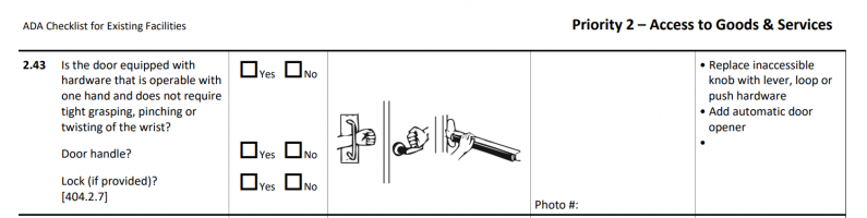

It's tempting to think of the new ramp and door as being "THE" accessible route, but not all disabilities require a person to be in a wheelchair. The need for lever hardware on doors rather than knobs is all about manual strength and dexterity, and the need for hardware that doesn't require "inching, tight grasping, or twisting of the wrist." Captain Hook had two good legs, but only one hand. He could walk up the six steps to the main entrance door but, if his one good hand was carrying "stuff," he wouldn't be able to open a doorknob with his hook. But he probably could release a lever-operated latch.

Another consideration: Are the main entrance doors (the old doors, with the knobs) part of a required path of exit travel? If so, I believe lever hardware is required.
1010.2.2 Hardware. Door handles, pulls, latches, locks and
other operating devices on doors required to be accessible by
Chapter 11 shall not require tight grasping, tight pinching or
twisting of the wrist to operate.
This section applies only to doors "required to be accessible by Chapter 11," so the AHJ may decide that it's not required for the main entrance/exit doors. There's a provision in the IEBC that says accessible means of egress are not required in existing buildings. As a long-time accessibility advocate, I don't like that provision, but my state didn't delete it or amend it, so them's the rules.
