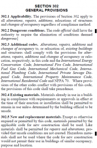

Should you choose to go there, from the IBC:
[A] 101.4.7 Existing buildings. The provisions of the
International Existing Building Code shall apply to matters
governing the repair, alteration, change of occupancy,
addition to and relocation of existing buildings.
Sends you to the IEBC, adopted or not.
I think Section 302 can get you there.
Here is what I sent to the contractor:
Mike,
Kicked it around and I don’t think we would be looking to get rid of the NM cable (assuming it was legally installed) unless:
  1. it was in an area that never had a ceiling before (so it would be “like new”)
  2. A change of use that brought in assembly or health care (IEBC 1008)
  3. Level 2 or better work in assembly A1,2,5; H ; or I uses per IEBC 808.2
For number 3, just have the electrician look at NEC 518 (518.4B in particular) and make sure nothing jumps out at him….But NM should be OK if the construction is not fire rated…Basically if it is allowed based on use it gets to stay, ceiling doesn’t play into it…
