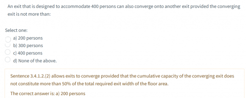

This is a quiz question about Ontario Building Code:
This is OBC:
3.4.1.2. Separation of Exits
(1) Except as permitted by Sentence (2), if more than one exit is required from a floor area, each exit shall be separate from every other exit leading from that floor area.
(2) If more than two exits are provided from a floor area, exits are permitted to converge in conformance with Sentence3.4.3.1.(2), provided the cumulative capacity of the converging exits does not contribute more than 50% of the total required exit width for the floor area.

My question:
1. Which exit is the converging exit? Is it the one that is designed to accommodate 400 persons?
2. Could you please draw a sketch to show the converging diagram indicating the 400 persons and 200 persons in the question?

3.4.1.2.(2) addresses situations where there are more than two exits, so let’s assume the quiz question is dealing with 3 exits. Lets label the 400 person capacity exit as No. 2, the 200 persons “stream” exit as No. 3.
I think what 3.4.1.2.(2) is saying is that the river (the converged exit, which is 400 person exit No. 2 ) should not contribute more than 50% of the total required exit width for the floor area, the 50% is not limiting the contribution of the “stream”, so the answer could be 300 persons.

Sorry, I was thinking about two different occupancies entering the same exit enclosure, but on re-reading your original post, it looks like it is exits from the same occupancy converging (re-converging?).
The intent of the code is to ensure that no one exit contributes ore than 50% of total exiting capacity (some exceptions to this for single exit allowances). This is to ensure that compromising one exit will not cause significant delays in egress. This clause just clarifies that you can't circumvent this requirement by separating and then re-converging exits.
I was going to say the question is poor, but we just cannot answer it. Insufficient information is given in the question. We also need to know what the required exit width of the floor area is before we can answer the question.

If your required exiting width is for 800 persons, the most you could have at any point along the exit would be 400 persons (max. of 50% of the 800 person occupancy).

The exiting capacity of each individual exit cannot exceed 50% of the required capacity (3.4.3.2.(6)).
3.4.1.2.(2) is just reinforcing this base concept.
In our imaginary scenario,
If there is a 800 person occupancy, at no point can the individual capacity of an exit exceed 400 persons.
We can have two 400 person exits
We can have one 400 person and two 200 person exits...
We cannot have an exit that serves 401 or more persons.

In real life design, I don’t think architects would often over design exits since space is always limited. However, the code doesn’t forbid you to over design ( like most of structural elements), but you are not allowed to over design one exit in order to under design another. There are wordings like “required exit width” or “exit width required” in the code, which implies there are cases where the actual exit width may be larger than the required width.
I can imagine that there may be scenarios where an exit is clearly seen by evacuating occupancy and the exit is over designed too much, people in panic while evacuating may all rush to this big exit, which is not the intent of the code.
I am just splitting hairs here for learning purpose only.
I like the way you put this. Yes, that would be the intent.
The intent of the code is to provide some redundancy in case one of the exits becomes compromised.
