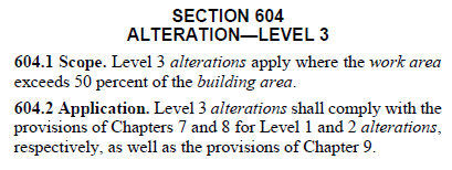

They are classifying it a level 3 alteration. To my knowledge and from what I was told the occupancy has been a B occupancy from the beginning.
They may call it a Level 3 alteration, but is it?

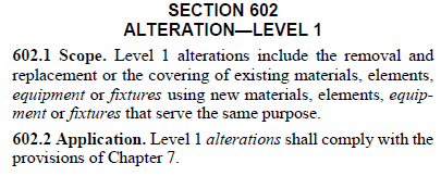

Just my opinion, but our State Building Inspector's Office agrees -- unless doors, windows, or walls are actually being moved, sheetrock (or plaster) is considered to be "finish," so removing the wall finishes but leaving the studs and not removing, adding, or relocating any doors or windows is Level 1 alteration work, not Level 2. And Level 3 is when Level 2 work takes place in more than 50% of the building, so they can strip everything down to the studs and replace all the sheetrock throughout the entire building and it's still a Level 1 alteration.

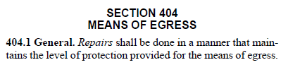

But I would also consider such work to be "repair, as defined in the IEBC:
As a repair, the work is subject to Chapter 4, which has a section on means of egress.
Basically, then, unless the work includes something that would elevate it from a Level 1 alteration and Repair to a Level 3, the code path seems to be in keeping with the underlying premise of the IEBC: keep existing buildings in use, and just don't make therm worse. However, as soon as they add, delete, or move ONE door or window, it jumps from Level 1 to Level 3. Section 905 of the IEBC refers to section 804. Section 804 includes the following:

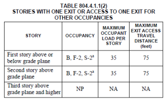

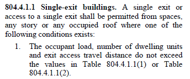

So now we're back to needing to look at occupant load and exit access travel distance -- but using tables in the IEBC rather than Chapter 10 of the IBC.
So they are limited to 35 occupants, which it appears they meet, and an exit access travel distance of 75 feet -- which cannot be evaluated without seeing the floor plan.
Agreed, but also note that level 2 and level 3 only apply if the space is being reconfigured (see the definition of "work area"). Yu can remove drywall in 100% of the building, but that doesn't make it a level 3. I see architects get this wrong all of the time.
