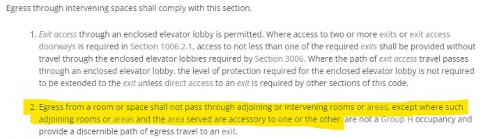

Opinions please on this:
One of the required exit paths in a restaurant passes from the circulation pathway through a dining area to the exterior. My questions are:
1. Does this violate section 1016,2 item 2?
2. Aside from being a trip hazard, does having to step up a few inches violate ADA requirements? There are plenty of seats where there is not step.
Thank you for your comments!

1. Doesn't seem like a violation since that's an eating area at a restaurant.
2. Yes, a step violates Section 303 of the accessibility code.

the 2023 Florida accessibility code seems to point to 2003 IBC for accessible means of egress requirements. 2003 IBC Section 1007 states that if more than two means of egress are required, then you need at least two accessible means of egress for the area. Unless you're altering an existing building (see IBC 1007.1, exception 1, which may apply) or that exit is one of two required accessible means of egress in a new building, then the step is in violation with code as far as I see.

I don't have a step in the exit path, so I'm good there.The exit path has a slight sloped section less than 4%. The slight step occurs on either side of that section of sloped walkway up to the seating area, maximum 6".

If the change in elevation is not ramped per ADA 303.4 wouldn’t it have to be a minimum 4” so it meets the requirement of a stair per ADA 504.2? But then if it was a stair you’d need a flat (maximum 2% slope) landing per IBC 1011.7.1, so your 4% slope can’t serve as a landing. Then there would also be the requirement for a handrail you’d have to meet.
The seating areas, the step down to the 4% slope, and the 4% slope are all parts of the exit access (per IBC Chapter 2, “That portion of a means of egress system that leads from any occupied portion of a building or structure to an exit.”), any requirement for an accessible egress route needs to be provided from the exit access.

I'm now a little confused. Don't you need to use the step to get to the required exit door?
Not sure if I am following...not all of the seating needs to be accessible........?
1109.2.9 Dining and Drinking Areas
In dining and drinking areas, all interior and exterior floor areas shall be accessible and be on an accessible route.
