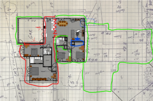

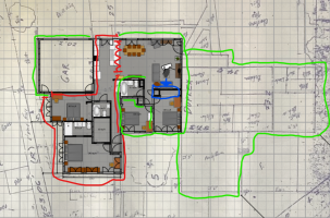

I attached a roughly sketched and scaled floor plan:
Green lines to show the existing duplex building areas, walls, and garage that I am not structurally altering
Red is the area of the addition
Blue is an interior wall I am planning to move a 2 feet over (living room area is a little small so every inch would help).
I'm assuming that this is not an easy question for anyone to answer with the details I've given. I'm trying to get as far as I can before I have to start paying out thousands of dollars to the engineer/architect and plan checkers, especially if I can determine this just isn't feasible. I'm trying to read through the building code to understand what I can expect to have to do to get this permitted/determine feasibility. Any and all comments or references to relatable codes would really help me!
There are things I might see if I could walk the site, but looks ok from just seeing the drawings. I did wonder if the the existing detached garage had a foundation suitable for it becoming attached and becoming load bearing walls for the addition. I can't think of other things that might be a really big deal. Any storm drains or other underground utilities in the area of the addition; utility lines overhead, could be costlier to overcome.

Thank you, yes I am working to get a design/builder out to walk it with me and review my plan but time is $ for a lot of builders who are extremely busy out in my area. And I hate spinning people's wheels without doing my own homework as much as possible and I also think its important that I am somewhat able to confirm what they are telling me and understand what they are saying. I am paying a licensed civil engineer a minimal fee to come out to meet me today onsite and review my plan and perform an inspection of the structural elements of the existing buildings. I am also getting a bid for a geological/soil study and a surveyor to confirm the precise the precise boundary lines.
In regards to feasibility, I'm really trying to minimize disturbance to occupancy of the other unit with this addition and alteration (my family lives in that unit now and will need to live in for a majority of the project and after). I'm trying to limit the scope of work as much as possible to minimize costs. I'd rather defer work on the other unit for as long as is responsible and we have the budget to do it. I have updated the plan to illustrate the additional detail I am providing below.
The garage is built on a 20x20 concrete monolithic slab with pretty thin walls - I'm assuming I'll have to lose square footage in the house to increase the thickness of the wall to accommodate insulation and fire rating where it attaches which would probably require me to changed my proposed addition footprint and add a little bldg square footage to my plan to keep the spaces sized as they are.
The existing building is on a crawlspace foundation (not sure if its bolted on). It has concrete stemwalls - not sure if they have rebar in them since I understand that may have not been a practice in the 1940s but this house could have possible been built in 1951 or later in the 50s. Maybe I should take a metal detector to them if it matters?
There are no overhead utility lines in the area of scope, they enter our property on the east side of the building opposite the garage side, do not run in front of the property, and enter the neighboring property from the south side, both over 50ft from scope of the addition. Water enters from the front but runs to the other unit first then t's off. There is plumbing for 2 meters but foolishly somebody decided to remove the 2nd meter and reduce to one meter awhile ago so we'd have to go through getting the 2nd meter back. We do have two existing electrical meters.
The existing detached garage and duplex roof is a tear-off replacement now due to its condition. We plan to replace the existing duplex front windows & exterior siding, extending/adding to the shared front porch concrete slab and extending a portion of the porch overhang to accommodate moving the existing front door of the addition unit with the addition closer to the street on the same wall to get more living room area. Municipality requires a building permit to do all of this so I'm figuring to do it all under one permit if possible at the same time to reduce costs with economy of scale.

The structural engineer I had looking at my plans and the duplex today recommended doing a sister foundation and wall along the outside of the garage instead of structurally attaching. And then doing a California roof that is not structurally supported by the garage, just lies on top. Do you think that would fly?1710045121206.png
The structural engineer I had looking at my plans and the duplex today recommended doing a sister foundation and wall along the outside of the garage instead of structurally attaching. And then doing a California roof that is not structurally supported by the garage, just lies on top. Do you think that would fly?View attachment 13089
Frost protection in California is generally 12" only (though in the Sierra's it may deepen). Generally the engineer's recommendations are close to what I'd recommend; however, if you're going to go to the trouble of pouring an additional footing and framing new walls around (outside) of the garage you might as well just demo the garage and build it new. Depending on how close to the side setback you are at the back corner of the garage you may not be able to do that anyway.
What you're proposing is fairly standard in most of California and - especially in your area - should go fairly smoothly.

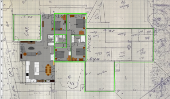

Please see my revised floorplan design, green lines to note existing walls, all other walls would be additional interior or exterior walls.
Plainly, I'm just trying to learn what can of worms I may or may not be opening with this project and what the most cost effective, yet prudent, final scope would entail. (Such as having to budget to replace the garage which would include removing everything that's in the garage and disabling it's use for the duration of the construction OR alternatively planning for a sister wall if that's actually feasible). Considering I need to financial plan now for the future. My philosophy in regards to planning is to ask all the questions to identify and assess all of the risks before committing. Being inexperienced, I'm just trying to figure out what questions I need to ask and issues I would need to explore. I appreciate any feedback/help so any and all comments are appreciated.
I'm not trying to achieve getting around anything that I'm required to do and I especially want to consider pros and cons as I do want to preserve this building for as long as possible as it is very important to my family. Nor do I think there are actual problems with the existing building, zoning, and setbacks. The property is not located in the City's map of problematic soils areas or natural hazards. The structural engineer I had out to inspect gave me a verbal opinion that he thought I probably had absolutely no issues with the soils considering the existing concrete stem walls for the duplex have existed for 70-80 years and have appeared not to budge an inch. I do have neighbors who have performed drastic renovations/rebuilds and I do not believe they had issues with the soils.
The engineer also said that the unit I am considering an addition to was built like an addition to the other unit with independent structural components and I could tear down the existing unit I'm looking at adding onto to the dirt and rebuild it if I wanted to.
What I am trying to do is plan ahead and figure out what a plan checker and inspector is going to be looking at in my design of the addition. And how to best design it so there are no oversights so I can try to eliminate unforeseen costs as much as possible before committing to the project. And I also am trying to evaluate if it makes sense to just tear down the unit and garage and rebuild - but I think that would increase the project cost quite substantially as opposed to doing just an addition and alterations to the existing unit.
