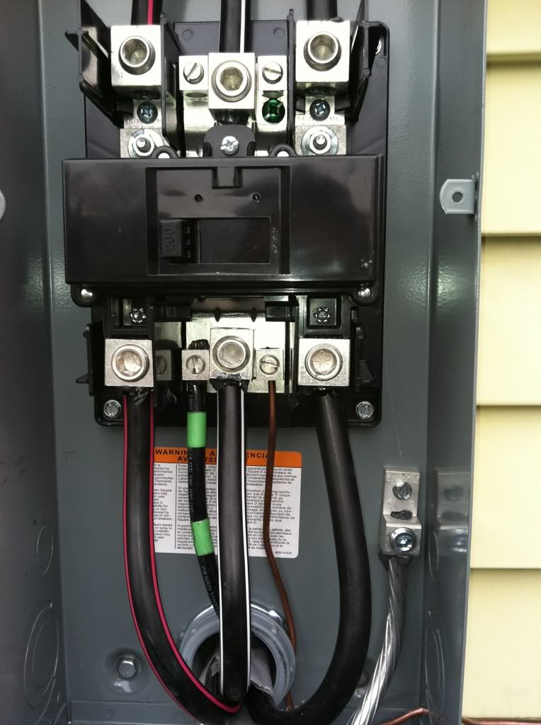

Exterior Main Disconnect Grounding and Bonding Connections
12,994
Top fed from meter. Bottom is feeder to panel in basement.
What say thee?
jar546 said:
It goes into the through the panel & out to the water pipe so yes, it is a grounding electrode conductor. The bare #6 goes to the 2 ground rods.
If that is a raceway that the GEC runs through then it must be bonded to the raceway with a bonding bushing on both ends of the raceway. (See 250.64(E) 2008 NEC)
Chris
