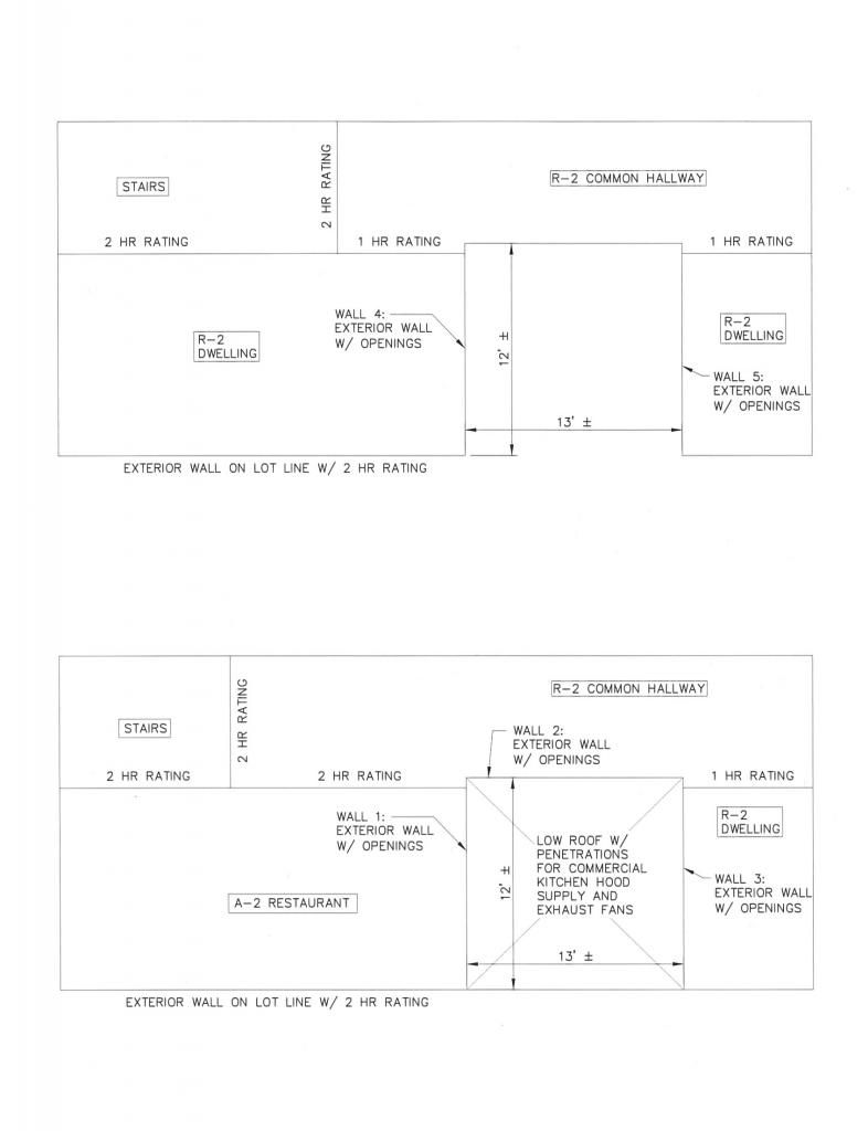

How do I determine the fire rating requirements, if any, for walls 1, 3, 4, & 5 in the sketches below? Do I apply a fire separation distance for exterior walls? Is the rating that which is required for separated construction or the rating required between dwelling units? Are the ratings non-existent because the walls face walls of the same building?
Wall 4 is the upper portion of wall 1 and wall 5 is the upper portion of wall 3. For separated occupancies, 2 hour fire separation is required between A-2 & R-2. One hour fire separation is required between R-2 dwelling units. The 12' x 13' area is a window well that extends from the roof on the first floor up to the fourth floor roof.
Wall 2 is load bearing and I know it needs a 2 hour rating. Load bearing vs non-load bearing conditions for walls 1, 3, 4, & 5 are not yet determined.

From Table 601, if the walls are non-load bearing, I go to Table 602 and look at fire separation distance.
Fire separation distance is measured from the building face to the closest interior lot line; the centerline of a street, alley or public way; or to an imaginary line between two buildings on the property.
Fire separation distance is not applicable in this scenario because I have an exterior wall facing an exterior wall from the same building. Or do I assume fire separation distance is greater than 30 resulting in a fire rating of 0?
You have 13' between the opposing walls. 6' 6" FSD for each wall (a bastardized application of the 'imaginary line' strategy).
Interesting concept.....Technically you do not need to separate the building from itself......If there is no lot line....

steveray, I know, that's why I added "(a bastardized application of the 'imaginary line' strategy)" at the end o my post.
The lower sketch shows the second floor. The low roof is approx. 13 ft wide from the inset portion of the building to the adjacent building on the opposite side of the same lot line. The low roof is approx. 12 inches above the R-2 dwelling unit floor and approx. 3 ft below the adjacent building roof.
The upper sketch shows the typical third / fourth floors.
