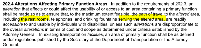

In commercial spaces, yes, ADAS 213.2 generally defaults to requiring all restrooms to be accessible, but there are exceptions for existing facilities:
Lastly, for ADDITIONS to existing buildings, the restroom requirements for the additions are only for those restrooms actually serving the addition, and 202.4 is not (in and of itself) triggering improvements to other restrooms.
