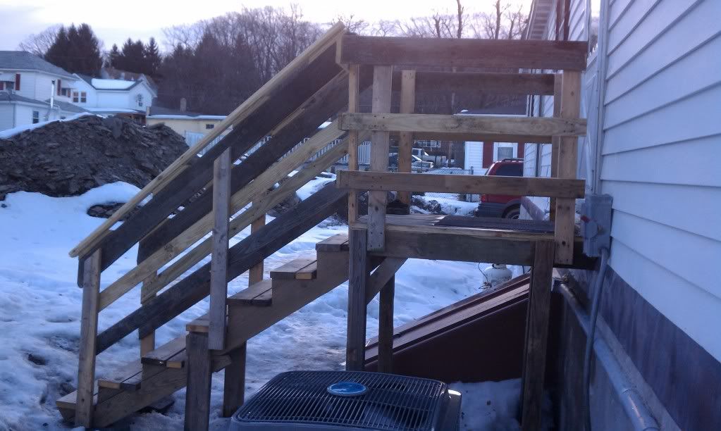

Not sure they get it. Don't know why I wasted my time citing code sections from the IRC.
Have patience, they're gettin' there. A couple more on the landing and they'll be fine. You might try getting away from "quoting" the IRC and "act it out" instead. More like a TV show.
The guards are a common fix for basement or back stairs where I come from, but what's holding the stairs up? Are those 1x3's?
What is the problem, the slope of the landing, the handrail gripping surface, open risers, guardrail openings and I am going to guess that drywall screws hold it all together. I am sure the homeowner is more than happy with their efforts. When did jar visit my community?

Not like you have a lot of time, but you might want to carry a copy of a sketch noting what compliance looks like with code section summary notes.
I found it works great when explaining to people what is wrong.
The SMA's Viz guides are great for those that can read, but to many pages for most that build a landing, stairs, guard and handrail like that and then ask you what is wrong.
Picture is worth 1,000 words, of with this maybe $35.00 bucks of scrap from a dumpster

hey, I just saw some 7/11 stairs in a house exterior stairway (actually, they were 11/7.. is there a difference)? I struggled to get up them as I have short legs..
Oh.. no handrail, either

All they gotta do is bring that dirt that's in the background in and place it around the stairs so it's only a couple of risers and the problem is solved!

Interesting handrail.. I don't think there is a section that requires it on the inside of the guard?
edit: uh I just noticed the first 3 steps have a different stringer than the rest.. and it looks like it's pieced together? :popcorn
