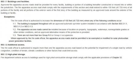

For reference look at the 2015 code edition to help clarify intent made by code change. Below is a screen shot of the 2015; note it adds "where any of the following conditions occur"
The 2012 commentary provides for item 1 "The code does not give the fire code official guidance on how much of an increase over 150 ft. is reasonable. The fire code official must make the determination based on the response capabilities of his or her emergency response units and the anticipated magnitude of the incident.
The "alternative means" in item 2 of the exception may include standpipes, automatic sprinklers, remote fire department connections or additional fire hydrants.
Hope this will apply satisfactorily towards your decision.

I think I disagree on the interpretations. My '09 reads the same as the posted '12, and says:
Exception: The fire code official is authorized to increase the dimension of 150 feet (45 720 mm) where:
1. The building is equipped throughout with an approved automatic sprinkler system installed in accordance with Section 903.3.1.1, 903.3.1.2 or 903.3.1.3. (<<< see that period?)
2. Fire apparatus access roads cannot be installed because of location on property, topography, waterways, nonnegotiable grades or other similar conditions, and an approved alternative means of fire protection is provided. (<< there's another one)
3. There are not more than two Group R-3 or Group U occupancies. (< and another)
There is no "or" between 1, 2, or 3, there are periods. If they wanted this to be an any-of-the-three situation, they would've/should've ended the exceptions with a comma, and an "or". The commentary doesn't clarify it any better, either. It could be argued that the '15, which is written much better, could point to increasing the distance, but strictly reading the 9 and 12, IMO, you've got to meet all 3.

  1. 1.The fire code official is authorized to increase the dimension of 150 feet (45 720 mm) where any of the following conditions occur:

Yes, all three are applicable (unless there are no Group R-3 and U occupancies, then only the first two are applicable). The second does state "location on property" as one of the qualifying conditions; however, it does state that "and an approved alternative means of fire protection is provided." Thus, the building must provide some means of approved additional protection--above and beyond what the code requires--to compensate for the lack of access. For example, this could be accomplished by increasing the sprinkler design from a lower hazard occupancy to a higher hazard occupancy (e.g., light hazard to ordinary hazard, or ordinary hazard to high hazard), or by compartmentalizing the building with fire-resistance-rated construction.
