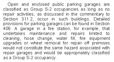

The 2021 IBC Commentary agrees that a fire department would be an S-2:
Same in S2:
[F]​
An automatic sprinkler system shall be provided throughout buildings used for storage of commercial motor vehicles where the fire area exceeds 5,000 square feet (464 m2).
Looks like IBC Commentary Figure 903.2 thinks an S-2 parking garage requires sprinklers if over 5,000 s.f. and if commercial vehicles are stored. See IBC 903.2.10.1. And the Commentary clarifies that this applies to the size of the fire area, not just the size of the garage.

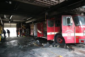

5. There are more things than just firetrucks in a fire station apparatus bay. The firemen will keep gear, equipment and even carry out some operations on the spot. Such as having a washing machine, some basic tools for rescue equipment servicing and so on. No-matter if this is permitted or not, it happens to every fire station I have visited on both sides of the Atlantic.
6. There are quite a few fire station incidents, we cannot ignore that fact.
