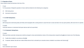

Here's where I got my answer (above) from NFPA 80, about using manual flush bolts where the doors are serving rooms not normally occupied by people:
6.4.4.5.1* Manually operated, labeled, top and bottom flush-mounted or surface-mounted bolts on the inactive leaf of a pair of doors shall be permitted to be used where acceptable to the AHJ, provided they do not pose a hazard to safety to life.
A.6.4.4.5.1 This provision limits their use to rooms not normally occupied by humans (e.g., transformer vaults and storage rooms).

If the doors are serving an A occupancy with a load of 50+ (if you're using the IBC), the doors will need fire exit hardware. On the topic of the individual components vs. assembly, it is uncommon these days to see everything tested as an assembly. You can have a rated frame from one manufacturer, a rated door from another, and rated hardware from a variety of manufacturers. The listings can also be from different listing labs - like some from UL and some from Intertek.
NFPA 80 is not super-specific but here's what it says:
4.2.7 Components.
4.2.7.1 A fire door assembly shall consist of components that
are separate products incorporated into the assembly and are
allowed to have their own subcomponents.
4.2.7.2* Except where restricted by individual published list‐
ings, a fire door assembly shall be permitted to consist of the
labeled, listed, or classified components of different organiza‐
tions that are acceptable to the AHJ.
4.2.7 Components.
