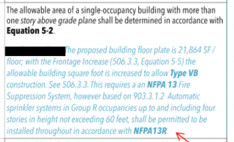

In this one case that prompted this post, the architect details that the allowable area is exceeded, but that they can still use a 13R system because 903.3.1.2 tells them they can. One of us is wrong. Gosh I hope it's not me.

Often, I find it is the question that needs improvement, not the answer. In this case I think you understand the question, even as poorly as I phrased it. I too believe the allowable area is covered by t504.2, and stands alone before you get to 903.3.1.2 but I have had two DP's ignore that and assume...I guess.... that 903.3.1.2 throws a blanket over any building 4 stories or less regardless of size. That is not the way I have always understood 903.3.1.2. I guess changing the code is probably a bridge that doesn't need crossed for my two DP's. I am pasting the most recent example here in case anyone really wants to dive in: (Note-The more I read this, the less I understand what they are trying to say.)

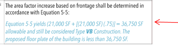

This is the justification in their code analysis for exceeding the allowable area (they do not present equation 5-2 anywhere). Note the "however" reference to 903.3.1.2:
I don't even know what to say about this one. I think they are showing the math for equation 5-1, but they call it 5-5, for the allowable area. They plug in the tabular area for a 13 system instead of a 13R system for equation 5-1, and then use the NFPA 13 tabular area instead of NS tabular area in the equation.
(They seem to call it frontage equation 5-5 but the actual math is allowable area equation 5-1, which should be 5-2)
I believe this entire code analysis was generated using some sort of AI, or some other canned tool, and this is why I don't believe the folks who say our days as plans examiners are numbered.....but I digress. I personally have never seen anything like it.
My math using equation 5-2 (frontage is .75)
At=[Aa+(NSxIf)]xSa
At=[7,000+(7,000x.75)]x3
At=[7,000+(5,250)]x3
At=12,250x3
Aa=36,750sf² *no single plate can exceed 12,250sf²
Both the single floor plate and the overall area are exceeded by my reckoning.
There are 9 full 24x36 pages of regurgitated code analysis like this, much of which is not applicable to this project. My head is spinning.
