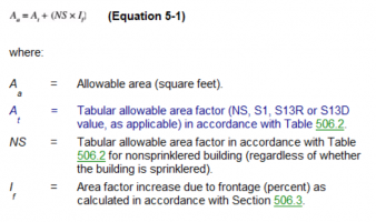

506.2.2 Mixed-occupancy, one-story buildings.
The allowable area of a mixed-occupancy building with no more than one story above grade plane shall be determined in accordance with the applicable provisions of Section 508.1 based on Equation 5-1 for each applicable occupancy.

I hadn't thought about the mixed non-separated as I didn't think it would allow enough square footage, but it may be applicable with both B and F-2 being 23,000 allowable Per 506.2 table non-sprinkled. With a frontage increase, that would be more than enough. (for this phase anyway, they are growing quickly). I try to encourage most all of our clients to sprinkle, but it is a significant investment at about 5-7 bucks a foot around central KS area (new construction)
