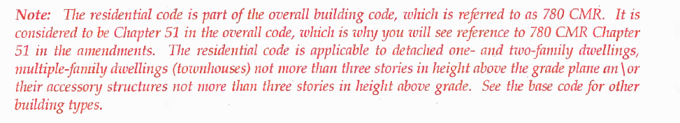

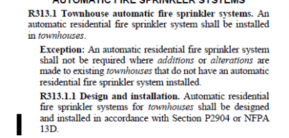

The Building code in Ma requires sprinklers for 3 families, not 2 or less family newly constructed dwellings. The IRC covers 1 and 2 family homes and townhomes.
The 148 laws are fire laws and are retroactive, this is new construction therefor the building code applies
Is the current building a 2 family home?
Is it a townhouse?
is it an existing townhouse?
Conversion is not a term used in the codes that I know of
Creating a new living unit could be addition and most likely a major renovation
Looks like the BO is correct

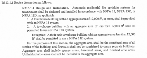

so the picture I have now is a 2.5 story building and you are creating 3rd living unit in the attic, definitely, a change of use, definitely under the building code, speak nicely to the Building Offical see if you can understand. 1 option to be denied the permit then appeal to the appeals board. 2nd option install a 13D system with tank and pump avoiding the whole water purveyor issues and sprinkler hook up fees and construction
26L is a local option fire law, has this been accepted by the community? If not an easy answer does not come into the equation. Also, it is an old law and the building code has been updated several times since 26L was available to the communities.
A tough thing about MA is the juxtaposition of fire laws and building codes, you have to comply with both and the exception of one does not carry over to the other.
26I Has defiantly been adopted by the town, I just cant interpret how it would apply with the change of use , as it only specifies how it applies to renovation.
This has defiantly been a learning experience for me trying to figure out the fire code vs building code . Everyone here as well as surprisingly at the building department and fire department has been pretty helpful.
Your picturing it exactly correctly. And if a sprinkler ends up being required , it looks like 13D is OK for R-Use buildings other than R-1 or R-2 dormitories with less than 3 units and less than 12,000 ft.
