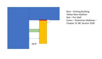

Tunnel, walk way, canopy between them,, Short one

I have a drawing, just trying to get it uploaded now.
Thanks for suggestion and sketch Builder Bob! Very easy to follow.
The current plan is to investigate the 3 hour wall construction and see if it can modified into a bonified 3 hour fire wall. (Our structural engineers know the requirements for a fire wall, so they can make the assessment.) The owner would like to keep the new building touching the existing buildings for passageways, reduced construction costs, and preserve land for future additions.
Once we are allowed in the plant to investigate, we will have a better idea of which direction we will go. It may end up with a separate 2 hour wall like RLGA suggested in an effort to best utilize building space.
