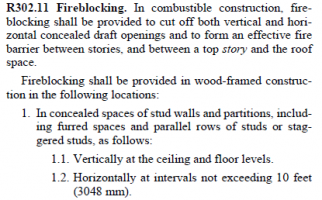

Per R302.11 fireblocking at openings at vents, pipes, ducts, cables, etc., must be of an approved material. This should not be confused with a listed product. "Approved", as defined in Chapter 2, means that it is acceptable to the building code official. Therefore, most products are not going to indicate whether or not they are 'approved' - usually they will indicate if they are listed. I think most building code officials accept the orange expanding foam insulation when used in walls that are not required to have a fire resistance rating.

R302.11 Fireblocking.
In combustible construction, fireblocking shall be provided to cut off both vertical and horizontal concealed draft
openings and to form an effective fire barrier between stories, and between a top story and the roof space. ...

R302.11 Fireblocking (4).
4. At openings around vents, pipes, ducts, cables and wires at ceiling and floor level, with an approved material to
resist the free passage of flame and products of combustion. The material filling this annular space shall not be required to meet the ASTM E 136 requirements.
A laundry list of fireblocking materials can be found in R302.11.1
